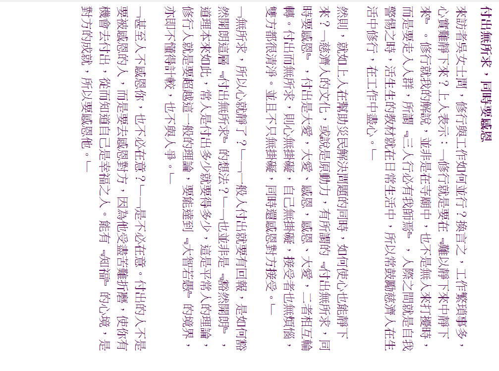

Old 11-17-2013, 05:06 AM   #187
Ng Teck Guan
Ng Teck Guan began at the beginning.
Posts: 5
Join Date: Nov 2013
Chinese text in vertical direction
Hello everyone, I am new to this forum.
I am looking high and low for a way to read my chinese ebook correctly on a desktop or laptop.
The original ebook is chinese characters in vertical direction. When i imported i open the epub in Calibre it becomes rotated ....please see link for image...
Does anyone know how i can resolve this by rotating the page 90 degrees, by changing the stylesheet or anything?
Any help is greatly appreciated, thank you very much.
Ng Teck Guan is offline   Reply With Quote
