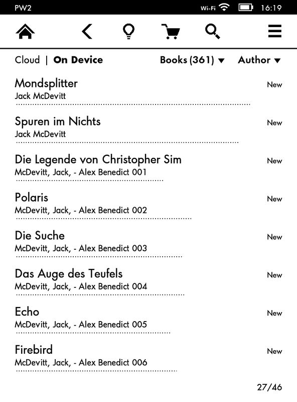

Can anyone please explain why this recipe isn't working for me?
Metadata Plugboard:
format:mobi
device:kindle2
source template1: {series_index:0>4.1f|| - {title}}
dest field1: title
source template2: {author}{#subseries_index:>2s| - {#subseries}| - }
dest field2:authors
OK, now the first template works just fine.
Heck, even the second template works fine when incorporated into the first, (minus the {author} bit of course).
My expected output for the second template is:
AuthorName - SubSeriesTitle - 1
What I end up with no matter where I put the {author} tag is:
AuthorFirstName - SubSeriesTitle - 1 AuthorLastName
Looking at it on the KT the books get sorted by SubSeriesTitle alphabetically.
Then by subseries_index, albeit correctly, then correctly by the title template.
So, an example of what's displayed on the KT if the above confused you:
25.0 - A Kingdom Besieged
Raymond E. - Chaoswar Saga - 1 Feist
26.0 - A Crown Imperiled
Raymond E. - Chaoswar Saga - 2 Feist
27.0 - Magician's End
Raymond E. - Chaoswar Saga - 3 Feist

Cross-posting an interesting idea from elsewhere, putting the series into the author field on a Kindle and displaying properly:
Originally Posted by PRS-T2 View Post
{author_sort:||,}{series:| - | }{series_index:0>3s}
Target = author_sort and authors.
I was happy a bit too early: for books where there is no series information, the Kindle still displays "firstname lastname", but the sorting is all right across all books, so...
Maybe that can be tricked with a blank after the comma. Will try it tonight.
Also, if a series has more than one author, like authors Preston/Child with the Agent Pendergast series, the series is grouped, however the index is wrong. Books will then be ordered by first mentioned author (Preston), then title. But at least all information is visible incl. index numbers, and the series is displayed in one block. I got used to this behaviour with my Sony already.
Attention: the plug will NOT work for series written by several independent authors, in my case there's only one: Justifiers. It's written so badly however, that I don't think I'll read it again
In such case I just use the search field which works like a charm and suggests the whole series after typing in a few letters...
That is interesting. I don't think anyone thought of adding a second comma to author_sort.
Me neither until I started thinking what the hell the kindle does to the author_sort field after sorting. The comma idea came after you explained the kindle way of handling that field as far as sorting and display goes.
Without that comma, it displays the line like this:
<Greg - Amboss 001 Bear>
With comma, either added to the series or author sort, or just put between them:
<Bear, Greg, - Amboss 001>
Which I prefer for obvious reasons

PRS-T2
PRS-T2 has read every ebook posted at MobileReadPRS-T2 has read every ebook posted at MobileReadPRS-T2 has read every ebook posted at MobileReadPRS-T2 has read every ebook posted at MobileReadPRS-T2 has read every ebook posted at MobileReadPRS-T2 has read every ebook posted at MobileReadPRS-T2 has read every ebook posted at MobileReadPRS-T2 has read every ebook posted at MobileReadPRS-T2 has read every ebook posted at MobileReadPRS-T2 has read every ebook posted at MobileReadPRS-T2 has read every ebook posted at MobileRead
PRS-T2's Avatar
Posts: 78
Karma: 65054
Join Date: Oct 2014
Device: Sony PRS-T2, Kindle PW2, Oasis 3
Here's what it looks like on the Paperwhite2 with FW 5.4.5.1:
(image attached)
