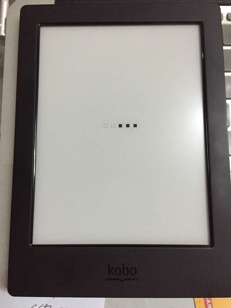

Trying to run the shell script from my Mac, I'm getting this error:
Extracting files to patch from 3.11.0_source/kobo-update-3.11.0.zip ...
tar: ./usr/local/Kobo/librmsdk.so.1.0.0: Not found in archive
tar: ./usr/local/Kobo/libadobe.so: Not found in archive
tar: ./usr/local/Kobo/libnickel.so.1.0.0: Not found in archive
tar: Error exit delayed from previous errors.
Cleaning up /var/folders/kf/4nkwy8sd7s39ym600dvch0pm0000gn/T/patch32lsb_XXXXXXXX.DMYDvKNl
logout
[Process completed]
I don't know what I'm doing wrong. I have the kobo-update-3.11.0 zip file in the 3.11.0_source folder. It should be kept zipped, right?
I don't know what I'm doing so please be gentle Thanks!
Update: I tried to run the bat file from a PC ang managed to get a tgz file which I copied onto my H2O. Upon ejecting, it seemed to update but it's been 10 minutes and it's still updating. I hope I haven't bricked my Kobo!
Update #2: In hindsight there may have been errors when I ran the bat file but stupidly assumed everything was fine because I got the tgz file anyway. Thankfully I've managed to do a factory reset so at least the Kobo isn't bricked.
Would still like to do the patch if someone can help me out but I probably won't be trying it again by myself without assistance from the experts
Just to exclude one possibility: Was your H2O running on FW 3.11.0 when you applied the patch? If you were under FW 3.11.0, it would be interesting to know the content of your tgz file.
And for my curiosity: How did you do the factory reset? By tapping at the top corners of the screen? If yes, did the reset start before the squares started running or afterwards?

Yes, I checked several times to be sure.
Trying to recheck what I did wrong -- the 3.11 zip file I transferred to the 3.11.0_source folder was this one:
Mark 5 Hardware : New Aura (and probably the Aura H2O)
(4d8eac1207, 16 Oct 2014)
72.9 MB - 74,690 KB - 76,481,595 bytes
from this thread here: https://www.mobileread.com/forums/sho...d.php?t=185660
I don't know if that is indeed the correct 3.11 file for the H2O?
Yes, this is the correct one.

Thanks. I'm stumped then. I've tried redownloading both the patch and firmware and running the shell script again several times (and on two different Macs), still come up with the error message. I'm afraid to run it through the PC again, because I might not be able to resurrect the Kobo again.
