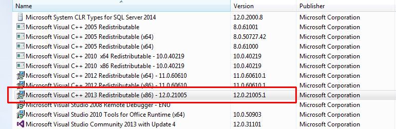

Posts: 22,399
Karma: 31000056
Originally Posted by Macburp View Post
I noted that when installing Sigil the install still tried to install the C++ library, even though I have it. Then - Sigil would not load.
@Macburp - Sigil 0.8.2 32bit working OK here.
Was the install of the C++ library successful ?
What version of the library shows in cp->programs and features - here's mine.
A few weeks ago I installed an SSD and completely rebuilt my system, I installed and I've since upgraded Sigil from here ==>> Release Sigil 0.8.2 Release
