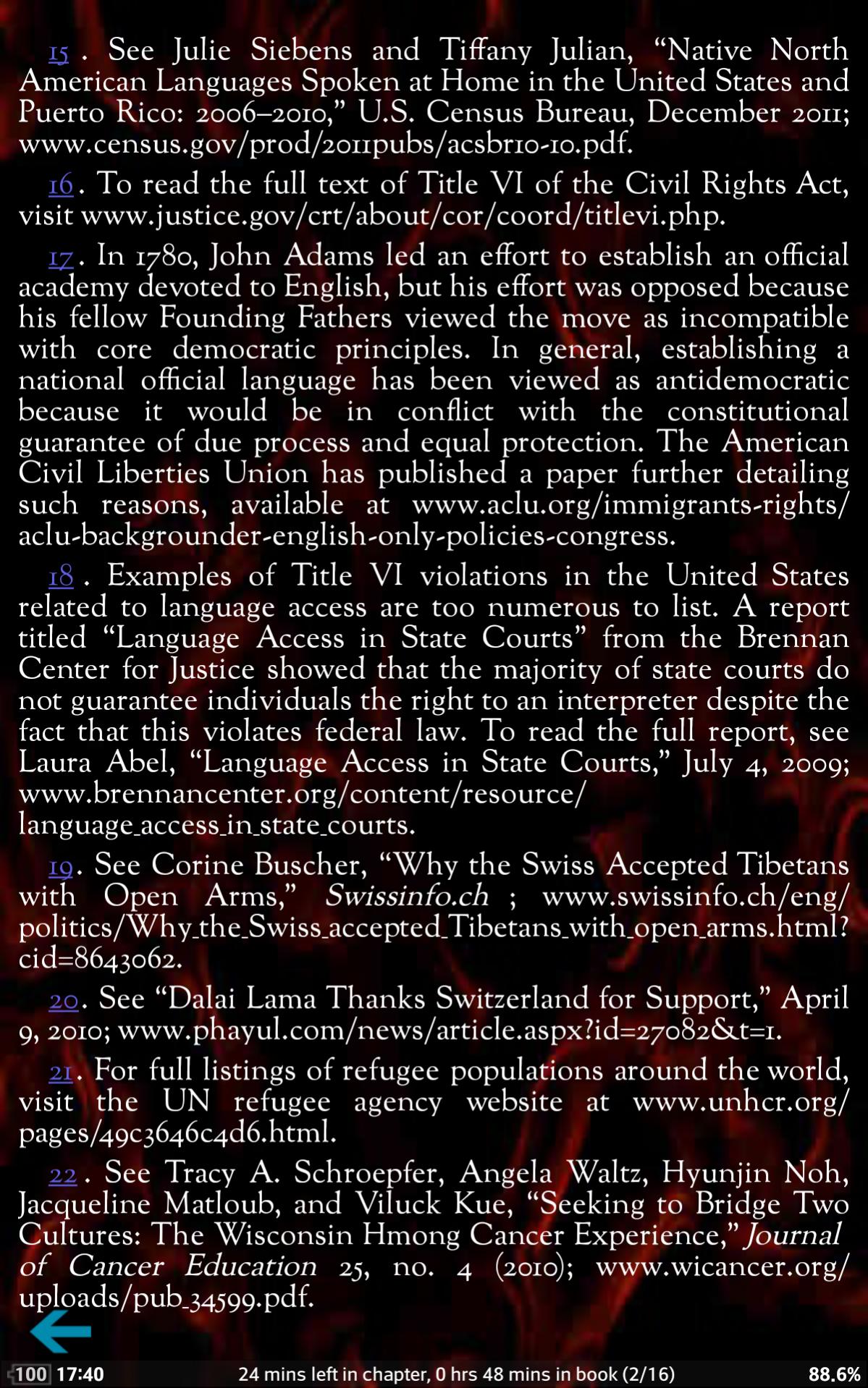

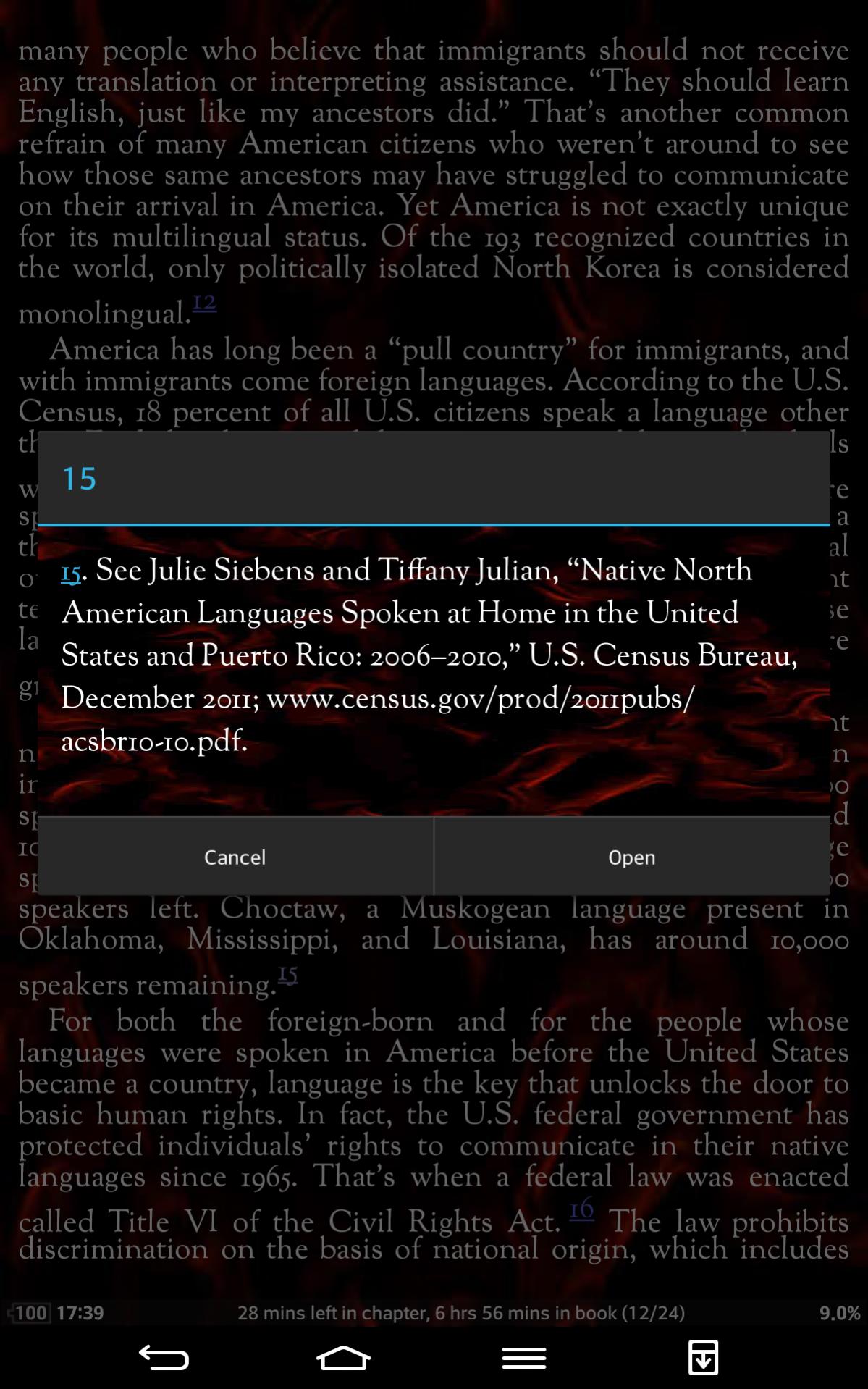

I'm reopening this thread because (cats and dogs notwithstanding) it is by far the most useful discussion I have encountered on the Internet after extensively exploring the topic of popup footnotes.
I'm currently reading a scholarly book with lots of footnotes in it, and I find it interesting that while this book does not display any popup footnotes in my primary e-reader, which is Marvin for iOS, nor do any footnotes from this book get displayed as popups in iBooks or Kindle or Kobo on iPad... they do get displayed as popup footnotes in Moon+ Reader Pro on Android. Moon must be doing it "intuitively/heuristically", as discussed previously in this thread, because there's nothing special in the coding to generate the popups – none of the stuff Elizabeth Castro talks about in her blog entry on popup footnotes. Just simple back-and-forth links of the variety Hitch quoted in this thread.
In fact, Moon+ Reader Pro seems to be giving you the best of both worlds: it first pops up a footnote, but it also gives you the option to subsequently press the "Open" button, and then you get transferred to the book's endnotes section where it may be more comfortable to read some of the more extensive footnotes. See the 2 screenshots from Moon, attached below.
ID:	130861   Click image for larger version
