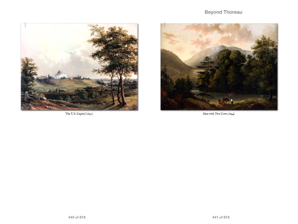

I checked it in my ADE copy on my PC and it works fine. Version 3.0.86137. It does exactly what you would expect.
Oh, Dale, the things you make me do -- like giving it another shot, just when I'd given up.
Okay, you inspired me to try again, and with a fair bit of frustration I managed to get the whole gallery of paintings done up (14 images w/captions in all), and everything seems to have turned out fine -- for the most part, anyway. It looks fine in ADE (I tried it in both v.3 as well as v.2, and it comes out okay in both), and then sent it over to my iPad to check, and although the images/captions aren't centered vertically on the page (as they are in ADE), that doesn't matter too much, I suppose.
What's weird on the iPad, though, is that each and every image has a little horizontal line added up at the top-left of the image -- see the attached screenshot here. I haven't got a clue where that comes from, it's not there in ADE, nor do I see anything funny that I might have added in my code.
And the text is so small. Oded (I think it was) had suggested 2em, I ended up going with 3em, but even still it's very small -- at least, when you're in a two-page spread like this. I could change it to 4em or something, of course, but then if you're in a single-page mode then it comes out way too big.
And this has me wondering -- once again -- whether I should just do it the HTML way as I was going to. That little line that's showing up is annoying, and what I don't like about this SVG method is that the font size for the caption changes along with the size of the pic, that I can't just have it be the size that I want it to be (regardless), in keeping with the font size(s) used elsewhere in my book.
I'm totally on the fence about this now, and not sure what I'll end up doing, as a result. :/

The example I gave you to illustrate the left/middle/right also drew a line at about the same point as the image you attached. Did you leave it in? It would be between a g statement. The original value of 40 maybe 50 pixels for the caption should be ok or if you prefer use pt (points) which also needs to be rather large. There is really no reason the numbers can't be big.
Oh, is that what that "path" line of code was about? I had no idea what that was for there, because in reading up about it on that site, it explained that you could do up text on a "squiggly" path or whatever. I didn't need to do that, I just needed a plain ol' regular, straight line, but when I deleted that line then everything screwed up, my text jumped up to the top-left of the image (with it "centered" at the top-left, i.e. so that it extended off-screen to the left).
I had no idea what that "path" line of code did (let alone what "stroke" and "fill" were all about), but I just left it in.
Here's the code that I ended up using in my HTML...
  <div>
    <svg xmlns="http://www.w3.org/2000/svg" height="100%" preserveAspectRatio="xMidYMid meet" version="1.1" viewBox="0 0 2048 1636" width="100%" xmlns:xlink="http://www.w3.org/1999/xlink">
      <image height="1536" width="2048" xlink:href="../Images/cranch1840-the_us_capitol.jpg" />
      <g style="font-size: 3em; font-family:English; font-style: normal;">
        <path d="M 100 10 100 100" style="stroke: gray; fill: none;"></path>
        <text x="1024" y="1586" style="text-anchor: middle">The U.S. Capitol (1840)</text>
      </g>
    </svg>
  </div>
I put it in a <div>, too because Sigil kept telling me that it was invalid if I didn't (although Pagina didn't -- and I do trust the latter more than the former, but it was annoying getting that one error).
I just wish I could have the captions set to what my "small" text is for the rest of the whole book, and have it just stay that size, no matter how big the image is (like, if you switch from landscape to portrait or whatever).
