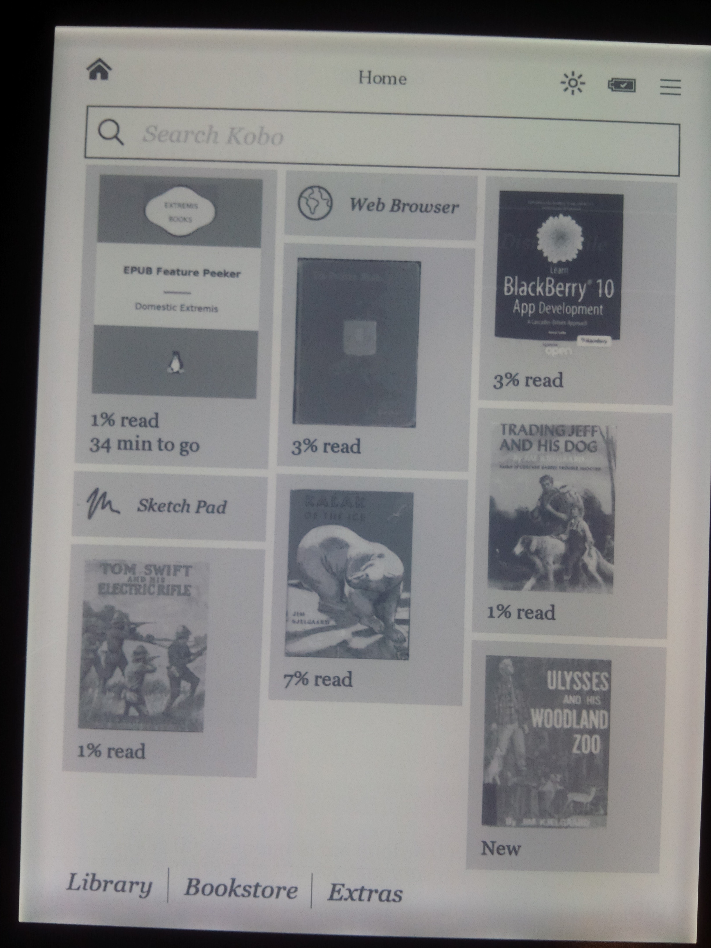

Old 11-06-2014, 01:30 PM   #130
Inkblot
Canadian and proud of it!
Inkblot can read faster than his screen refreshesInkblot can read faster than his screen refreshesInkblot can read faster than his screen refreshesInkblot can read faster than his screen refreshesInkblot can read faster than his screen refreshesInkblot can read faster than his screen refreshesInkblot can read faster than his screen refreshesInkblot can read faster than his screen refreshesInkblot can read faster than his screen refreshesInkblot can read faster than his screen refreshesInkblot can read faster than his screen refreshes
Inkblot's Avatar
Posts: 13
Karma: 14122
Join Date: Oct 2014
Device: Kobo Aura (N514)
Here's GeoffR's home screen patch on my Aura.
Inkblot is offline   Reply With Quote

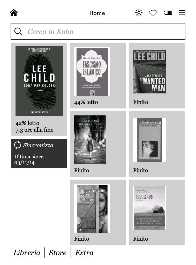

Old 11-07-2014, 03:52 PM   #135
Cesco
Cesco can illuminate an eclipseCesco can illuminate an eclipseCesco can illuminate an eclipseCesco can illuminate an eclipseCesco can illuminate an eclipseCesco can illuminate an eclipseCesco can illuminate an eclipseCesco can illuminate an eclipseCesco can illuminate an eclipseCesco can illuminate an eclipseCesco can illuminate an eclipse
Cesco's Avatar
Posts: 52
Karma: 8236
Join Date: Jul 2013
Location: Italy
Device: Kobo Aura 2-Aura H2O-K1-LibraH2O
I just need to have a home page similar to the one I have on glo, however I'll do some tests with kobo utilities, thank you for your answer
Cesco is offline   Reply With Quote
