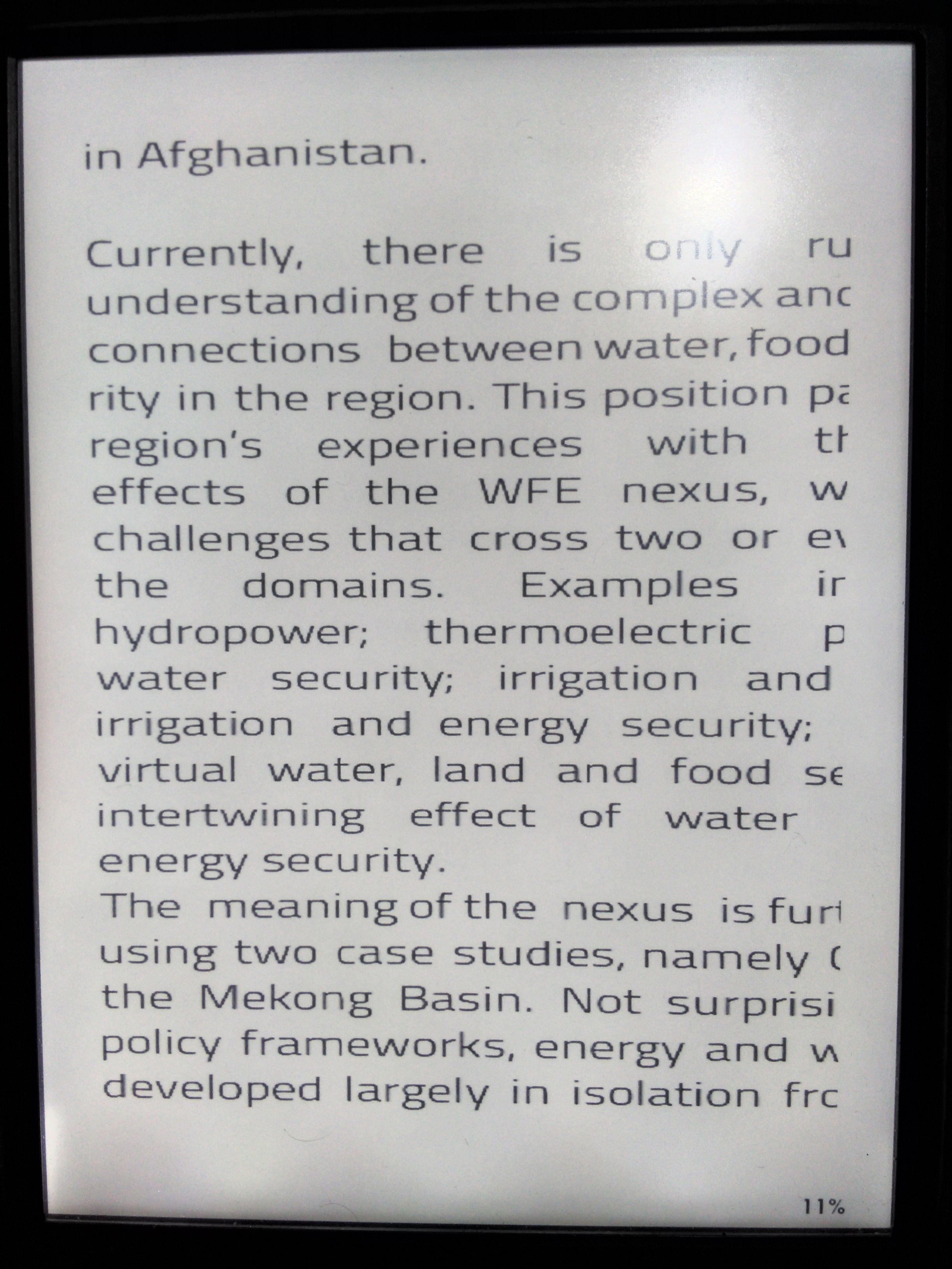

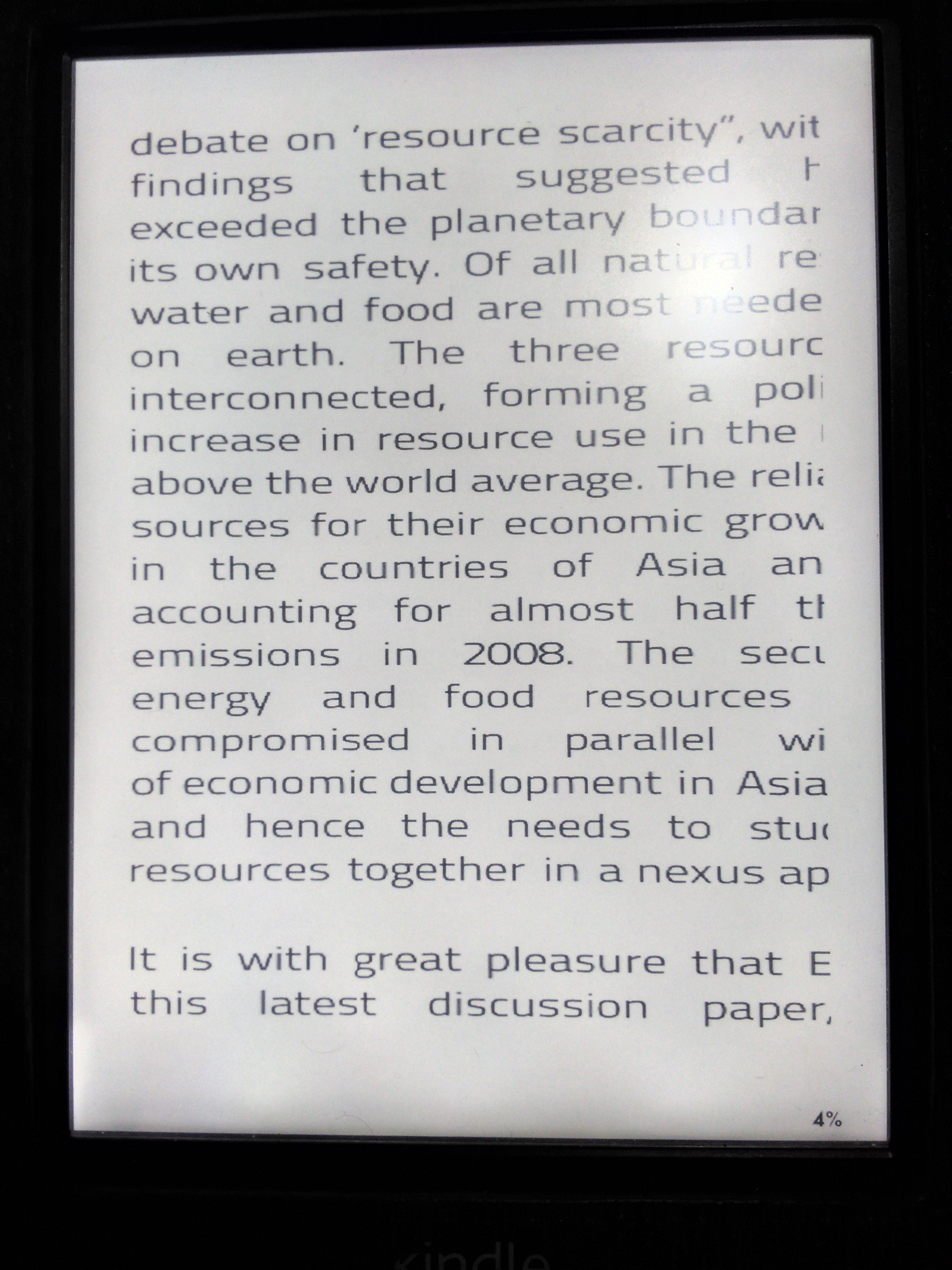

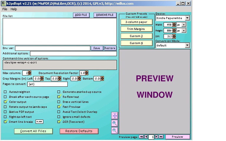

Hey Willus! I wrote you quite a while ago, I totally forgot to reply... I have included my previous post below:
Hi Willus!
Thank you very much for your effort making your program, even for free. It's a magnificent idea!
Anyway, I don't know why but I can't make it work correctly for a Kindle PaperWhite. The new optimised pdf looks fine in the computer after the program conversion (choosing Kindle PaperWhite as the device within your program; last version from November), but when I try to read it in my device, it's at low resolution and with the right margin distorted. Unfortunately, it makes it unreadable. What am I doing wrong?
Thank you very much in advance for the feedback!
Cheers and keep up the good work
P.S.1: I got the same error with the previous version (September, if I'm not mistaken).
P.S.2: I have attached all the files you required me. I had cropped it with Briss, but the result was the same without using it.

@jdofo -- There are a couple issues here. The first issue is that you appear to have uncovered a bug in k2pdfopt where the -c (color output) option inadvertently keeps k2pdfopt from putting tiny dots at the corners of the page (done by the -mc option). These tiny dots get the kindle to correctly fit the page to its screen. But since you're using a kindle paperwhite, you should just turn off the color output. That should fix your problem. In the mean time I'll get that bug fixed for the next release.
The second issue is that you don't need to turn on OCR for your particular example. Your source PDF already has a text layer, and this will automatically be passed on to the k2pdfopt output by default. Turning on OCR (with Tesseract) only slows down the processing significantly.
Let me know if turning off the color output fixes your issue.

It's definitely fixed!!! Wow, thank you very much Willus, you're very skillful. Thank you also for the quick reply and sorry for this long delay. Cheers and have a good day!
