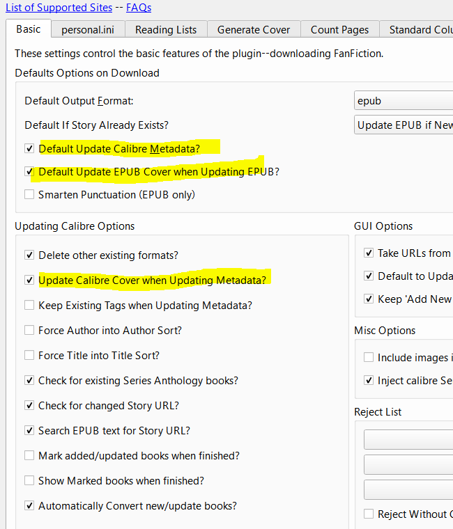

Man, I've been using this plugin on FimFiction for a while and it really, really stunk not having it available! Thanks for getting this stuff fixed so quickly!
Quick question- I noticed when I was downloading e-books directly of FimFic that the cover art was showing up in my Calibre library automatically as soon as I import them. For as long as I've used FFDL, I've always had to manually add in the cover art to the book metadata after downloading (even though it shows up in the epub itself if I view it in the calibre reader).
Is there some setting I may have screwed up somewhere that is causing this?

Fimfiction recently updated its epub-generating code, perhaps they weren't marking the cover image with a "cover" semantic flag before.
Personally, I've only ever downloaded the epub from Fimfiction when I'm away from my home computer, so that I could tell FFDL to "update-overwrite" it when I got back. So I haven't been paying a lot of attention to their format changes.

Originally Posted by baggins41 View Post
... For as long as I've used FFDL, I've always had to manually add in the cover art to the book metadata after downloading (even though it shows up in the epub itself if I view it in the calibre reader).
There are tons of settings in FFDL. The three I've highlighted below should all be on to update the metadata cover, as I recall.
