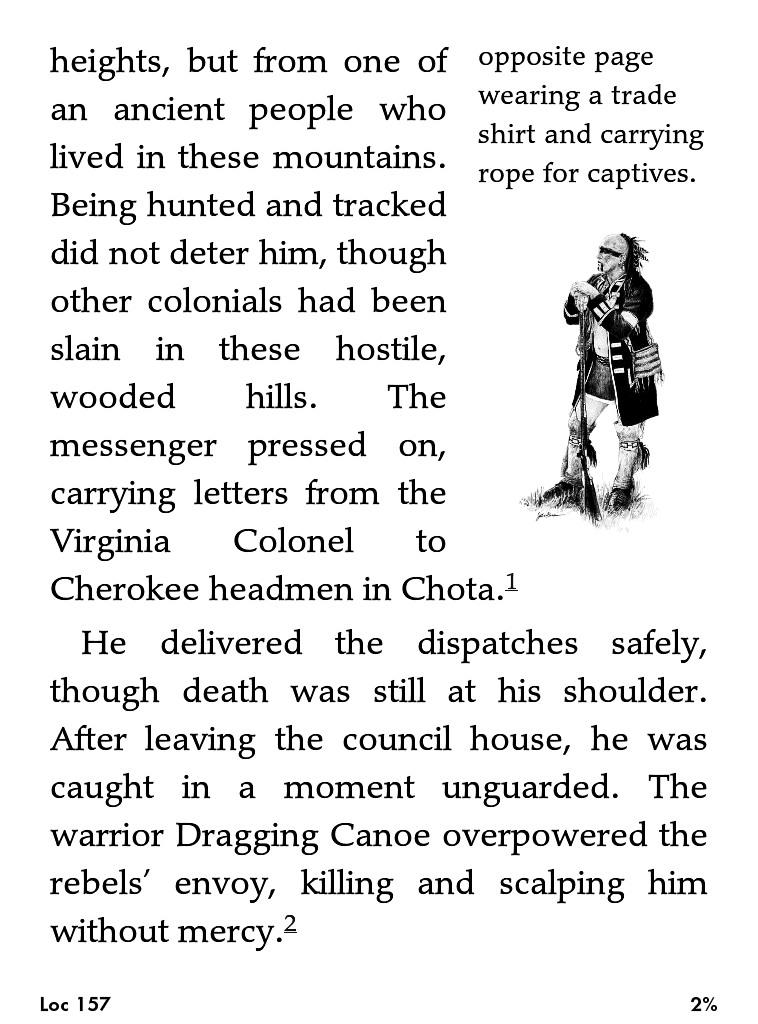

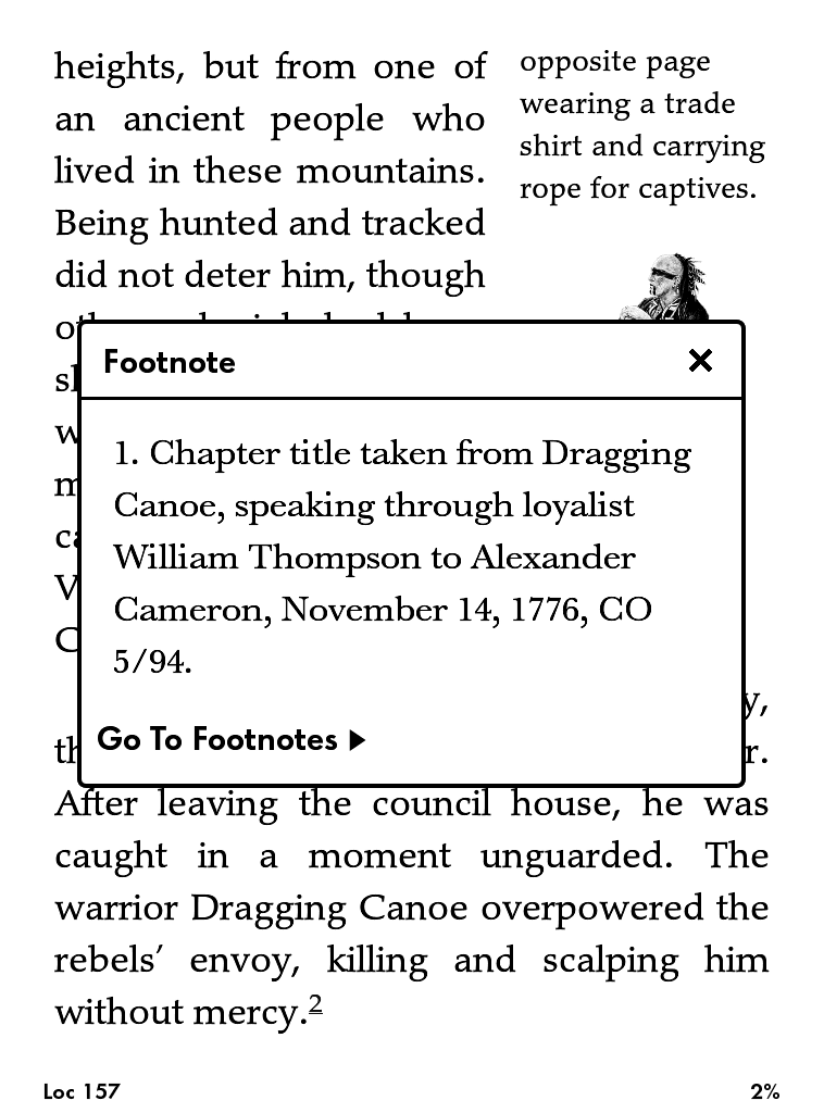

I don't mean to be dense, but we haven't had to add anything "special" to make pop-up footnotes work with Mobi format on the PPW. We make the footnotes the same way we've always made them, with two-way linking, and they work fine on my PPW.
Here's the coding for this footnote (in context):
The messenger pressed on, carrying letters from the Virginia Colonel to Cherokee headmen in Chota.<sup><a href="../Text/end.html#aa1" id="bb1">1</a></sup>
And here's the coding for the footnote itself:
<p class="note1"><a href="../Text/chap01.html#bb1" id="aa1">1.</a> Chapter title taken from Dragging Canoe, speaking through loyalist William Thompson to Alexander Cameron, November 14, 1776, CO 5/94.</p>
...and I've attached screenshots of the results. There's no fancy here. Just footnotes. Nothing more.
