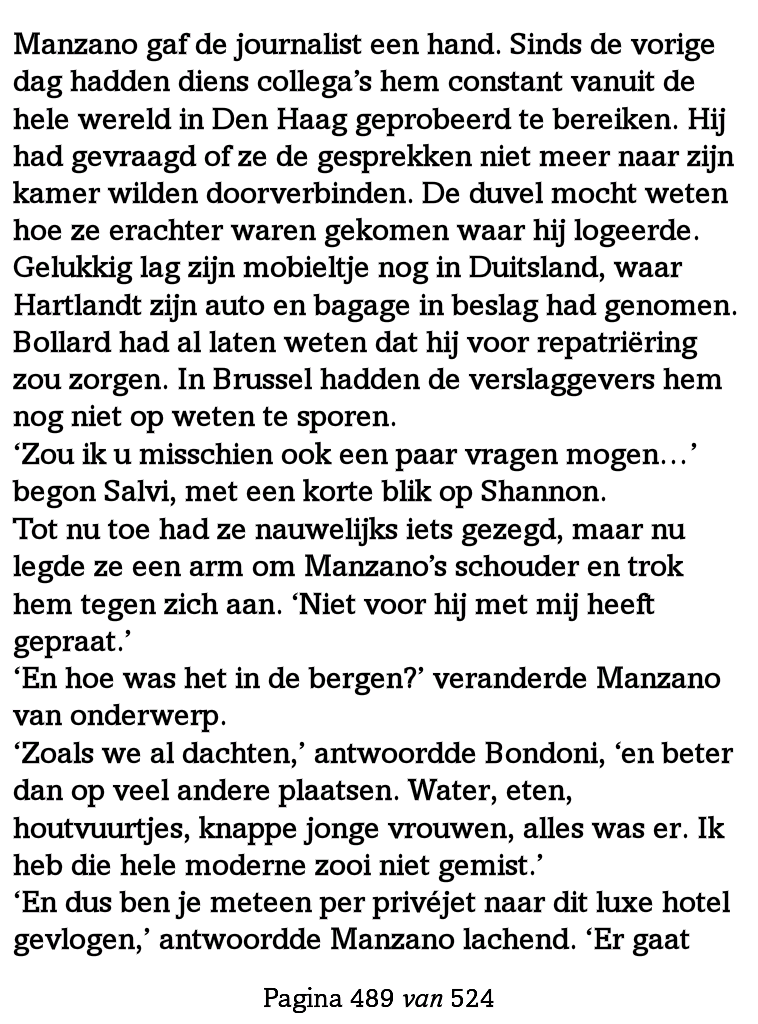

Is there any form to set sharpness always in maximum value (with no relation with weight)?
In firmware versions until 3.1.1, sharpness and weight settings were independent. I always set sharpness on maximum. I think the transition between pages looks to be faster. Is there any pach to recover that feature in the new firmware?
I don't like the "Page xx of yy" format for the footer, but I still want to see the "pages", so I'm using this patch:
<Patch>
patch_name = `Custom footer`
patch_enable = `yes`
# Changes the footer text with something shorter
# (not sure how it affects translations)
replace_string = CAA164, `Page %1 <i>of</i> %2`, `%1/%2`
</Patch>
Now the footer is simply "xx/yy". Similar patches could be done for the percentage and time left formats, I guess.

I really like this as well and added it into the patch and it worked great. I added a space before and after the slash though so it's not all crowded together which makes it easier for my decrepit eyes to read.
<Patch>
</Patch>
Isn't the length supposed to be the same?
Like this:
replace_string = CAA164, `Page %1 <i>of</i> %2`, `     %1 / %2        `
Or does that not apply in this case?

The replacement string has to be the same length or shorter, in this case.
I think I tried with spaces before the %1, and the footer came out off-center. I don't remember if spaces after the %2 made it centered again, but just removing the spaces was easier.
A side effect seems to be that it also changes the format of the "Page %1 of %2" texts in other parts of the interface (settings, search results, etc.).
With the spaces before and after the slash, so the page numbers will be 57 / 412 instead of 57/412, it stays perfectly centered and it's just easier for me to read.
I hadn't noticed that it also changed search or settings yet, but that's not a problem at all for me, it could change the page numbering to that system everywhere on the reader and I'd be happy. I know why Kobo uses italics in some spots, so you know you can click on it, but for some reason I find it visually off-putting to see "Page 57 of 412." And if I see numbers at the bottom or certain places in the menu, I know they're page numbers, I find the extra text just odd to have there. I was able to make that same change to my Sony 350s with PRS+.
I probably wouldn't mind it as much if it was entirely in italics instead of just the word "of" in the middle of it.

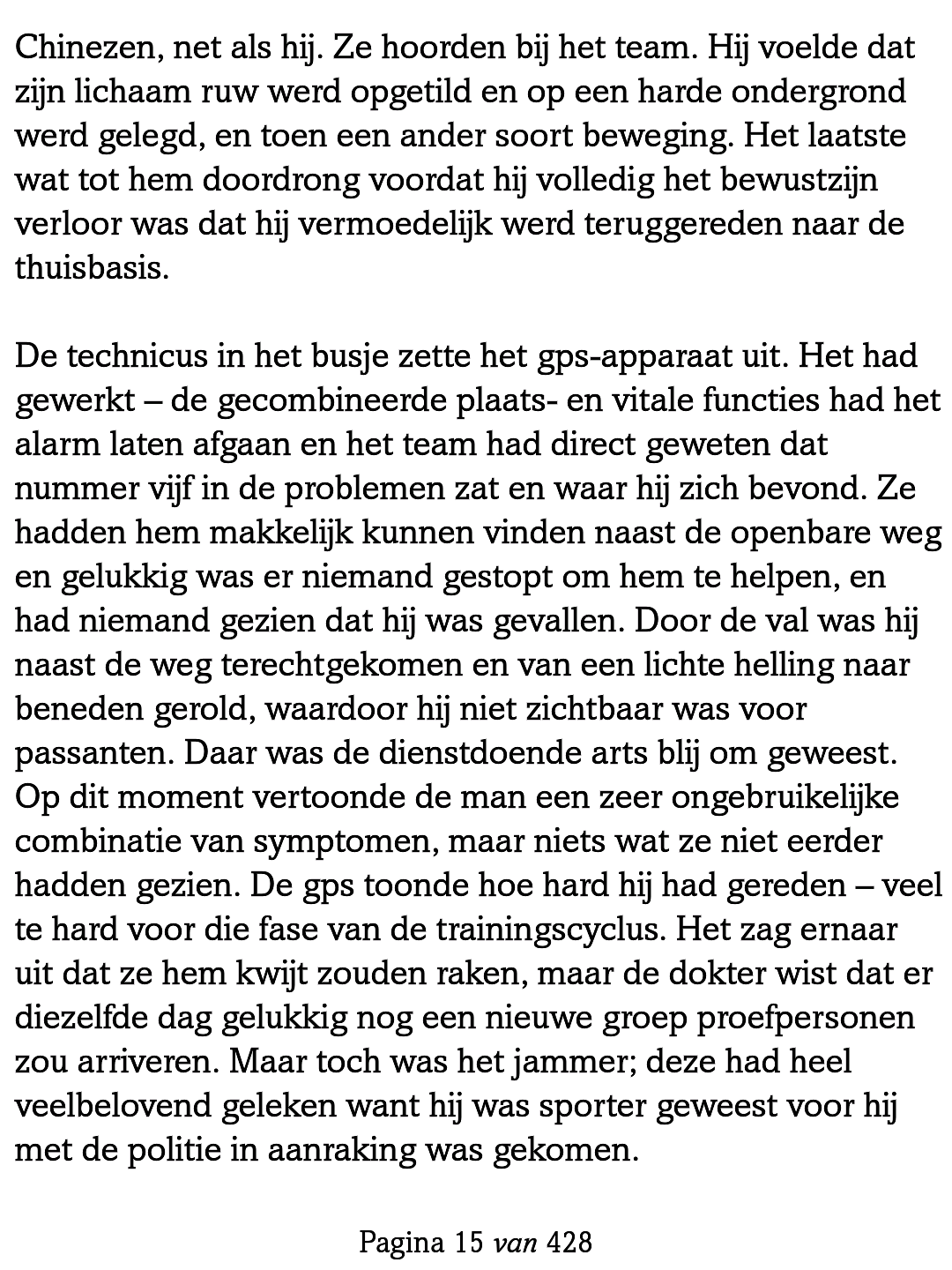

Played a bit with these settings.
I use this settings now for Glo and Aura HD:
<Patch>
patch_name = `Custom reading footer style`
replace_string = DBDBFC, `ReadingFooter {\n\tmin-height: 70px;\n\tmax-height: 70px;\n\tqproperty-footerMargin: 105;\n}\n\nReadingFooter[qApp_deviceCodeName="phoenix"] {\n\tmin-height: 82px;\n\tmax-height: 82px;\n}\n\nReadingFooter[qApp_deviceCodeName="dragon"] {\n\tmin-height: 120px;\n\tmax-height: 120px;\n\tqproperty-footerMargin: 170;\n}\n\n* {\n\tfont-size: 16px;\n}\n\n[qApp_deviceCodeName="phoenix"] {\n\tfont-size: 20px;\n}\n\n[qApp_deviceCodeName="dragon"] {\n\tfont-size: 26px;\n}\n\n[qApp_localeName="ja_JP"] {\n\tfont-family: A-OTF Gothic MB101 Pr6N;\n}`, `ReadingFooter {\n\tmin-height: 70px;\n\tmax-height: 70px;\n\tqproperty-footerMargin: 105;\n}\n\n* {\n\tfont-size: 16px;\n\tpadding-bottom: 0px;\n\tmargin-top: 0px;\n\t/*font-family:none;*/\n}\n\n[qApp_localeName="ja_JP"] {\n\tfont-family: A-OTF Gothic MB101 Pr6N;\n}`
# Uncomment the replace_string lines of one of the examples below, comment out
# the rest. If you choose to make further changes to the examples, BE CAREFUL
# NOT TO ALTER THE LENGTH OF THE REPLACEMENT STRINGS! (Add or remove spaces if
# necessary to keep the total length the same.)
# Example for Nick's Glo:
replace_string = DBDC0D, `min-height: 70px;`, `min-height: 40px;`
replace_string = DBDC20, `max-height: 70px;`, `max-height: 40px;`
replace_string = DBDC3D, `footerMargin: 105;`, `footerMargin: 105;`
replace_string = DBDC58, `font-size: 16px;`, `font-size: 28px;`
replace_string = DBDC6A, `padding-bottom: 0px;`, `padding-bottom: 7px;`
replace_string = DBDC80, `margin-top: 0px;`, `margin-top:10px;`
# Example for Nick's Aura HD:
#replace_string = DBDC0D, `min-height: 70px;`, `min-height: 50px;`
#replace_string = DBDC20, `max-height: 70px;`, `max-height: 50px;`
#replace_string = DBDC3D, `footerMargin: 105;`, `footerMargin: 170;`
#replace_string = DBDC58, `font-size: 16px;`, `font-size: 35px;`
#replace_string = DBDC6A, `padding-bottom: 0px;`, `padding-bottom: 8px;`
#replace_string = DBDC80, `margin-top: 0px;`, `margin-top:13px;`
# Uncomment one of the following if you wish the footer to use a fixed font.
# (And enable one of the Custom header style patches below using the same font.)
replace_string = DBDC92, `/*font-family:none;*/`, `font-family: Amasis;`
#replace_string = DBDC92, `/*font-family:none;*/`, `font-family: Avenir;`
#replace_string = DBDC92, `/*font-family:none;*/`, `font-family: Georgia;`
</Patch>
Gives me this result: ( still a bit to much wasted space on the Aura HD bottom,but I can't get that better.)
ID:	130187 Glo. and Click image for larger version
ID:	130186 Aura HD.
Thanks GeoffR for pointing out where the values stand for, the more I know what the values do, the more I can find my way in it.
Nick_1964 is offline   Reply With Quote
