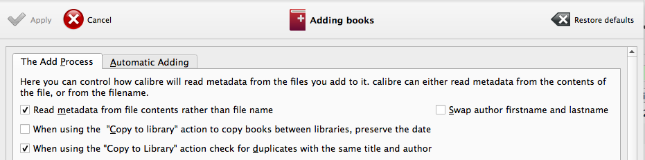

Go to Preferences : Adding Books and look in the top right corner:
Name:	Screen Shot 2014-10-23 at 10.21.26 PM.png
[CLICK ON IMAGE]

Thank you ....
Are you saying to use the option to switch the first and last name? That would mandate that the books and been pre-separated before adding them, correct - divided into ones that need to be reversed and those that don't.
I know in MP3 tag editors, this is usually a feature to correct tags already read into the program. Something like that would be nice.
