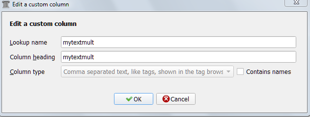

The custom column you created is probably not "Comma separated text, like tags ...", but is instead "Text ...". The first type lets you put multiple values in the column. The second treats the contents as one value.
ID:	129543   Click image for larger version
