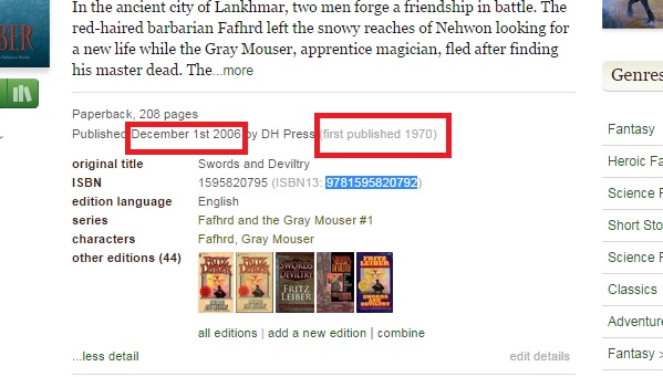

Is there any way to scrape the "first published" date from goodreads?
E.g. "Swords and Deviltry" https://www.goodreads.com/book/show/...s_and_Deviltry
The book was published in 2006 however the first time it was published was 1970 (attached screenshot).
So far I have been unable to ever get calibre to store the 1970 date and I always get 2006
I have tried selecting and unselecting "Use published date of "first edition" (from worldcat.org)" - it makes no difference.
Thank you
