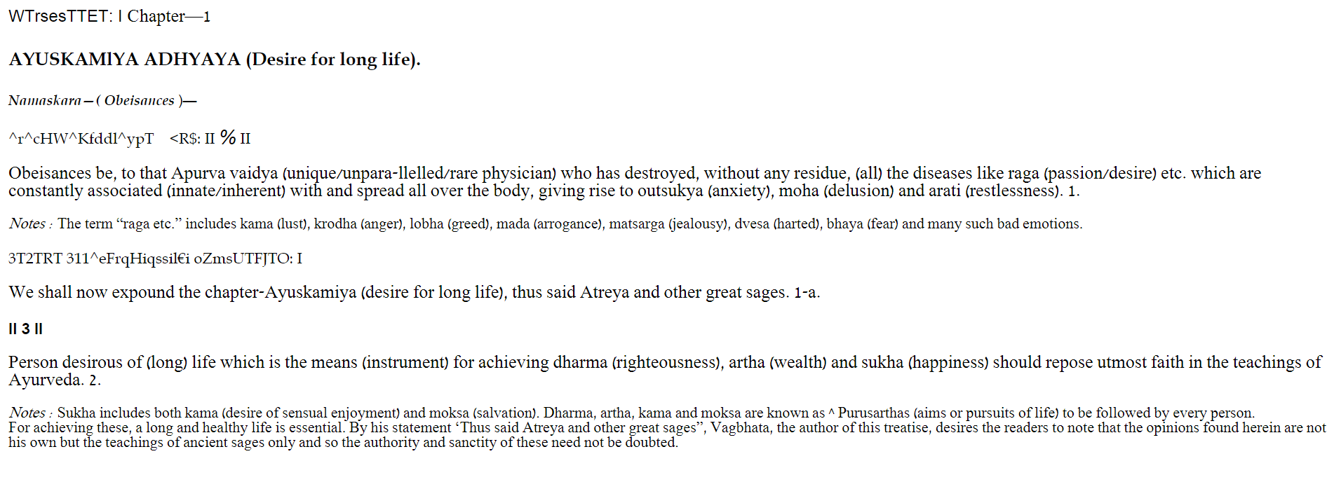

Hello guys,
This is a sample page from one of the books scanned using 1DollarScan (600 dpi):
https://www.dropbox.com/s/j18r16ed7t...0Page.pdf?dl=0
I was thinking of trying Custom Book Scanning for the following reasons:
1. They offer ePub/MOBI for $10 more.
2. Their PDF scan is supposedly 1200 dpi.
I saw posts of users here trying to convert their PDF to ePub by first converting it to HTML by Abbyy Fine Reader.
Here's that page converted to HTML (Please refer to attachment).
1. Based on the results, I feel that an ePub would be terrible for my book.
2. Also, I read that scanning with higher DPI hurts OCR. Is that true?
The main usage of these eBooks are just for text searching. I would have hard copies of the same books.
Would really appreciate any comments on this.. So sorry for the long post!

No matter how you go from PDF > ePub, you have to A/B compare the PDF to the ePub. You have A/B compare every character, every space, every punctuation mark, EVERYTHING in order to make 100% sure your ePub has no errors added by the conversion.
I've seen too many PDF > ePub conversion where you know the source was PDF and the errors are due to the conversion.

Most OCR packages have a recommended range of resolution, including a maximum. Whether or not (or how much) it hurts the process is debatable, and likely depends on a lot of factors. But beyond about 300 dpi, it doesn't really help.
Don't most book scanning services include an OCR option? It's a heck of a lot easier to covert a Word file to epub than PDF.

Sorry, not completely true. For most books 300dpi would be sufficient, but it really depends on the source. I scan at 400dpi and get a lot less OCR errors, especially with older pockets and paperback. Everything over 600dpi would be overkill. Downside is the decrease in scanning speed. I find that 400dpi is a good tradeoff.

1. No scanning service can convert a pdf into a decent epub/mobi. There are too many OCR errors in scanning to even consider this, so save the $10.
2. A pdf scan of 1200 dpi for an ebook is overkill and just produces a monstrously large file that will choke most programs.
3. I buy the books to read, so my workflow is to convert the pdf to html in Abbyy Finereader and then to convert the html to epub using Sigil. I have a pretty good idea of what to look for now, so the whole process is not that tedious and time consuming. My accuracy rate is about 95%, which is sufficient for me since I do the conversion for my own use only (I'd rather spend the time reading instead of comparing every single character).
If you only need the ebooks to search text, would not a simple scan to pdf with OCR work? Why would you need to further convert them to epub/mobi?

An OCR accuracy rate of 95% is an error in one character in 20, or about 1 in every 4 words, which is pretty appalling. Decent OCR should give you accuracy of about 99.9%, or 1 character in 1000, or about 1 in every 200 words (roughly 1 error per page).

The main problem I see with super high dpi is that every smudge, dot, etc on the page becomes an character you have to get rid of. The only benefit at all might be for pictures if there are lots of them and they are very high quality. I don't think this is the common situation for out of print books, and if you are talking about eink, a colossal waste of time since the resolution is so low.
