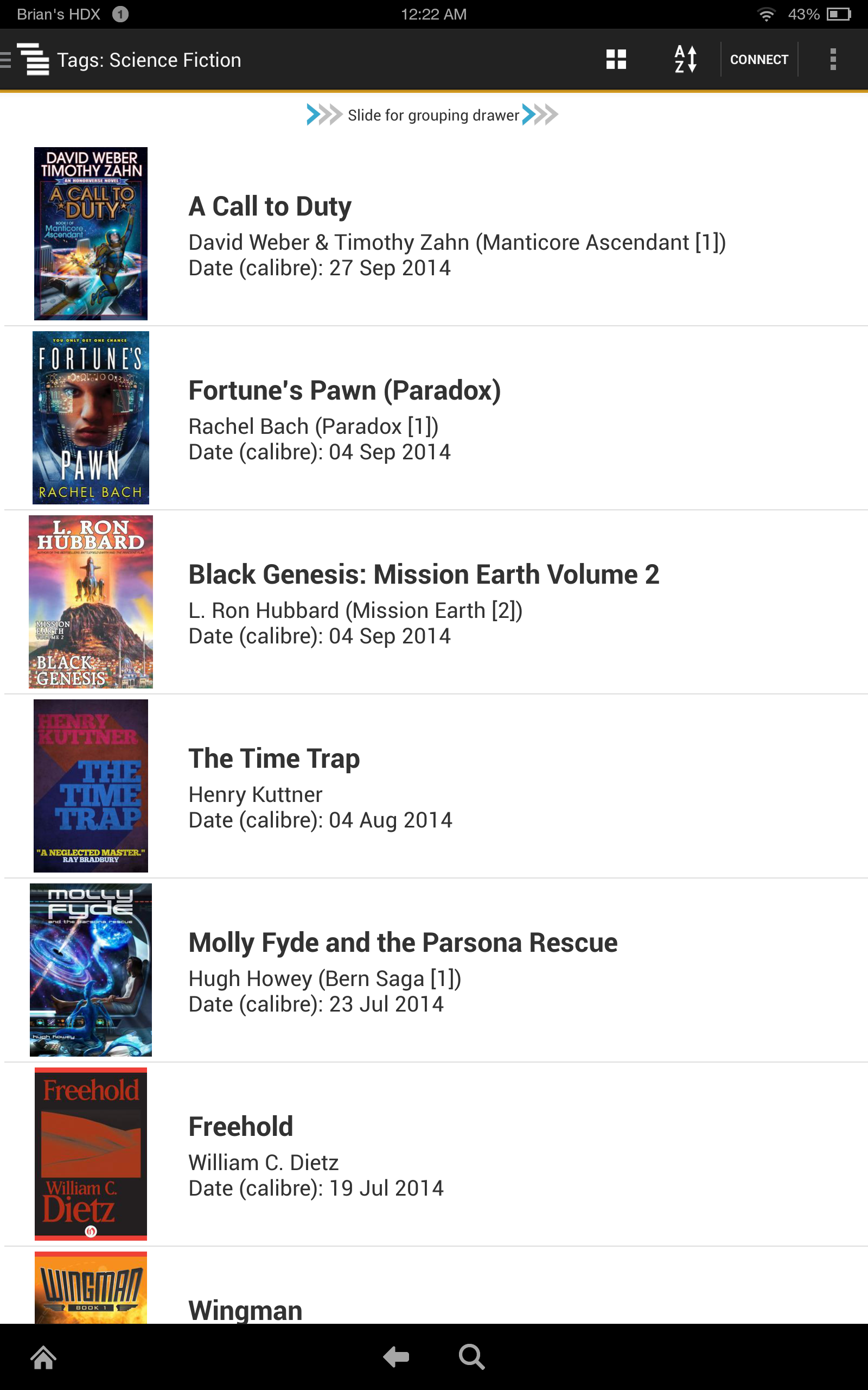

Okay, I finally got around to changing how I mark books read in Calibre to a Y/N column. In CC it shows in a books details if it's read or not, but it's not showing in the book list (see attached). Is there some setting I'm missing? Also is there a way to get the mark to show on the cover grid (perhaps a small mark on the corner of the cover)?
I'm running 3.4.4 (from the Amazon store) on a Fire HDX 8.9

Old 09-28-2014, 03:04 AM   #5

You have to set Settings->Book List->Show Read Information.

i assume that this depends 1) on having a custom colunm called "read" in calibre, and 2) on manual updates to that column on PC.
I don't have that setting available. I did figure it out however. I had an error in my sync column value, it works now.

That is in the alpha release. The production release shows it as a text box.

There is no way that CC can know if you finished the book, but it does know if you started reading it as long as you launch the reader from CC (which I don't think you do). Set CC's option to update the "last read date" when you launch the reader. Sort in CC by that date and set the read indicator for any books you have finished.
