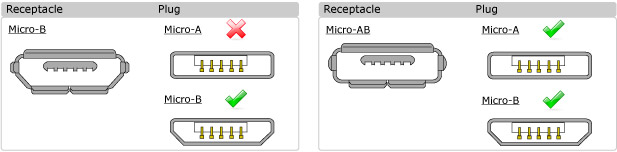

I'd suspect most of them are micro-B plug/receptacle. The rectangular micro-A plug is used on the master end such as one laptop I have that uses a micro-AB USB 3 receptacle for 1 of it's 3 USB 3 ports. Sadly after close to a year, I've never seen a device that came with a matching cable. By the time I do, I suspect I will be hunting USB 3.1 C connectors instead.
Basically, the chamfered corners of the B plug let it fit into into a B or AB socket but the square corners on the A plug will not plug into a B receptacle.

I'm wondering if it is like my son's old phone. To allow for placing a cover over the USB connector, they recessed the micro-B connector by a millimeter or so. The cable that came with the phone worked fine but most of my cable collection did not work and the ones that worked needed you to push in on the cable the entire time you were connected to the computer. When I measured the plug, the length from the end of the plug to the overmold was about 1.2mm longer on the phone cable compared to my cable collection oddly matching the recess depth.
