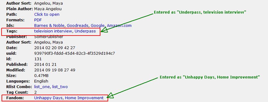

I create a custom column like tags - fandom/Fandom
When I enter Tags they are sorted in the Book List and in Book Details
When I enter Fandoms they are sorted in the Book List but they are not sorted Book Details
If I use the template {tags:sublist(0,1,\,)} I get the first Tag in an alpha sorted list.
If I use the template {#fandom:sublist(0,1,\,)} I get the first Fandom I entered.
Is there any way I can get a list of Tags in the order I entered them?

Any of these three options will keep them in the order that you enter the information:
Column like tags with Contains Names checked
Text, column shown in the tag browser
Long Text like comments
I'm currently using all three in my import library for pairings because I can't decide which method I prefer.
I have submitted code to Kovid for a new formatter function "raw_list", an analog of the existing raw_field function. It returns the list in the order found in the db. Example:
{tags:'sublist(raw_list($, ','), 0, 1, ',')'}
The code is in source now.

Can someone furnish me with a template that will examine the first character of the first tag and if it is '!' then return the substring of first tag from position 1 to end, otherwise return the first tag. I tried but it didn't work
So !Underpass would return Underpass and Crossover would return Crossover.
{tags:'re(sublist($, 0, 1, ','), '^!', '')'}
Tried this, but unfortunately, it only returns the alphabetically sorted tag list, not the original one that is also displayed in the metadata.
Actually it returns incorrect information. The raw_list function requires a field name, not a value.
Try
{:'sublist(raw_list('tags', ','), 0, 1, ',')'}
However, I must note that depending on the order of entry of tags is problematic. If *anything* happens to that first tag, for example a case change operation, then the order will change. The order can change for other reasons as well. If the "first" tag is as important as it appears to be then you should create a text custom column (not like tags) and enter it there.

Thanks chaley, works fine. I would prefer using tags, but I understand the danger there. Anyway, at least I know have the choice.
