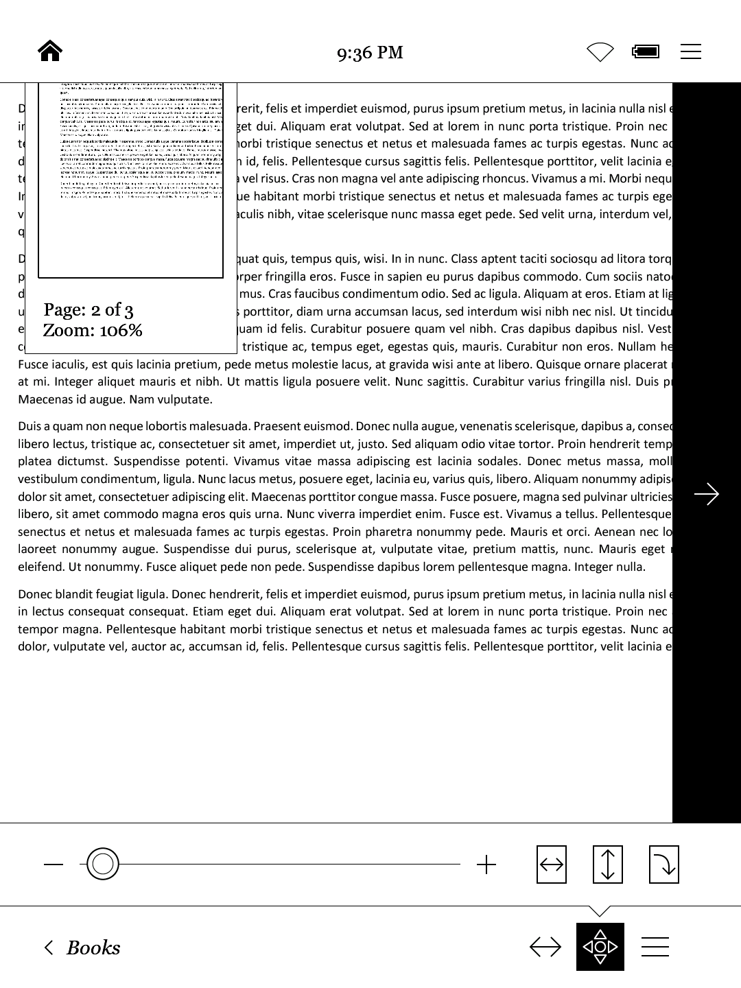

pdf page cut (with test file)
Hi,
Pdf display fine if the whole has the same orientation.
But, if the first page is portrait, and the next is landscape, then the landscape pages are trimmed (cut).
Hope this helps
Regards
François

I remember seeing that a while ago with the local train time table. The pages were sized for a small page and worked very well on both the Glo and Touch. But, there was one page that had a different orientation and it didn't work. But, I thought it had been fixed as I don't remember seeing that recently.
What firmware version are you seeing this with?

Hi David,
FW 3.8 without any modifications.

Ooops, I missed this thread and I have started another thread for it... Sorry!
As expected I can confirm it. I really think that the problem is that pdf viewer gets locked in the very first page size... You get cropped pages in either Landscape>Portrait or Portrait>Landscape.
AuraHD with 3.8.0. in my case.

Yes, if you add a bigger page at the beginning of the pdf, it doesn't crop anymore. I've seen this bug for a long time, though
Python hack to add an empty page with size of biggest page in pdf.
PyPDF2 needed: https://github.com/mstamy2/PyPDF2
import PyPDF2
import sys
ifile = sys.argv[1]
pdfinput  = PyPDF2.PdfFileReader(open(ifile, "rb"))
pdfoutput = PyPDF2.PdfFileWriter()
print pdfinput.getDocumentInfo()
n = pdfinput.getNumPages()
maxw = 0
maxh = 0
page0 = pdfinput.getPage(0)
for i in range(n):
    page = pdfinput.getPage(i)
    w = page.cropBox.getWidth()
    h = page.cropBox.getHeight()
    if w > maxw: maxw = w
    if h > maxh: maxh = h
print maxw, maxh
firstpage = page0.createBlankPage(None,float(maxw),float(maxh))
print "writing ..."
pdfoutput.addPage(firstpage)
for i in range(n):
    pdfoutput.addPage(page)
# finally, write "output" to document-output.pdf
outputStream = file("document-output.pdf", "wb")
pdfoutput.write(outputStream)
