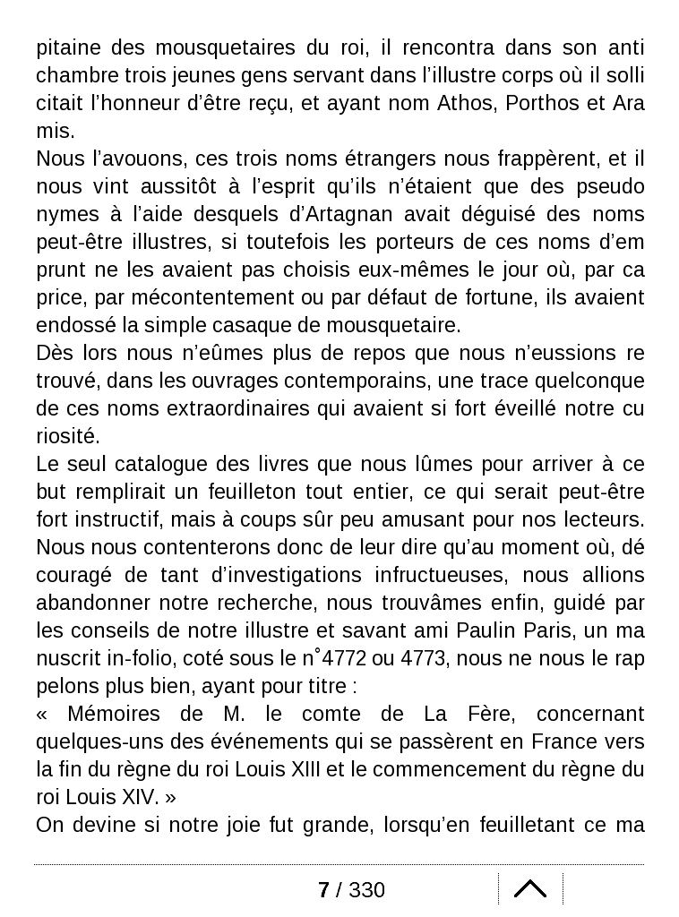

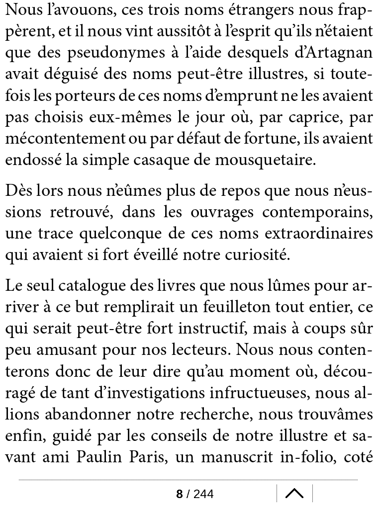

It looks to me like the soft hyphens are handled correctly using both of the reader apps on my 623. I've provided a screen shot from each so that you can see if they are displayed correctly.
Edit: Whoops, it looks like fbreader doesn't handle hyphenation correctly. I don't see any being added at the end of lines. Strange.

Thank you very much !
Hyphenation seems correct on the first screenshot. Is "Adobe viewer" the default reader ?

Yes. The default is AdobeViewer, and you have to perform some extra steps to use fbreader instead.
