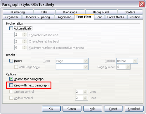

@Arkadian - In Word if the Header paragraph style has Keep with Next checked then after a DOCX->EPUB it wont be split from the following paragraph. LO should have a Keep with Next attribute on Paragraph styling, see attachment - its from AO but LO should be v similar.

I did have it... in fact I didn't have this problem at all within LO.
However, it doesn't seem to hold true here, at least not in my iPad/iBooks...
