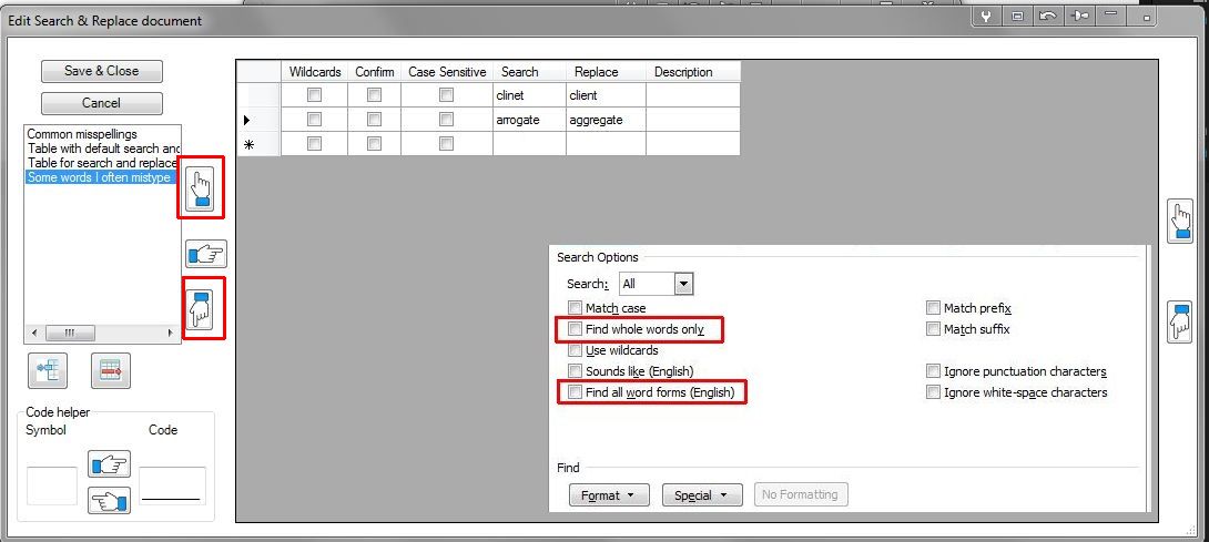

Re Search and Replace Settings
In the list on the left - should the up/down pointers move rows in the rules document Table 1, it didn't when I tried it. But I edited Table 1 in the rules and got the result I wanted.
Could the line items have a check boxes for whole words only and find all word forms
I'm finding the S&R really useful for dealing with transcriber abbreviations; different transcribers use different abbreviations <sigh>

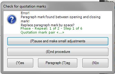

I'm getting "Paragraph mark found between opening and closing mark!" errors around some dialogue paragraphs that have no leading or trailing attribution, in passages such as this:
Mary swept into the room looking like the cat that got the cream.
"It's beautiful day."
After a glance outside Fred said glumly, "But I think it will rain later."
But it appears to be inconsistent, i.e. its not all unattributed dialogue paragraphs.
Does the presence or absence of dialogue attribution play any role in the Dialogue Checking? I think it may depend on whether the following paragraph contains dialogue. And it may only happen when the search direction is Up. If I can find a consistent pattern I'll report back.
This makes no sense at all. There is no difference between unattributed and attributed dialogue for the procedure. As long as curly quotes are used, all will be picked up. As a very brief explanation, part of the procedure is finding an opening mark and then grow the selection until it either finds a paragraph mark, an opening mark or a closing mark. In the latter case it is fine and the next opening mark is found. The other cases require action. On the way back it is vice versa. If you get reproducible false hits, I would be very, very interested in that since it would (almost) impossible.

I think I understand what you are saying here. I will check, I haven't touched that part for quite a while. You mean editing the S/R document within the settings, right?
The attachment shows the pointers I refer to - not a big issue this, the document is easy to change manually
Originally Posted by Toxaris View Post
Not getting what you mean here. If you mean by line item a search request, than you can do that yourself by putting that into the S/R request. If you put your search between <>, it should only hit complete words (wildcard search only). That is normal S/R behavior for Word.
The attachment also shows the bottom part of Words Find/Replace dialogue. I have highlighted the whole words only and find all word forms conditions. I was wondering if those two conditions could be placed in the table along with Wildcards and Case sensitive.
whole words only - Say I want to replace leaned with leant, but I wouldn't want cleaned to be changed to cleant. So in vanilla Word S&R I would check whole words only. My experience is that using a leading or trailing space wont work because of adjacent quotes and punctuation.
find all word forms - I would use this if I wanted to do replaces such as realise with realize, it will pick up words like realisation, realised etc. I import quite a lot of documents where both the US & UK spelling variants are contained within the same document The Word dictionary I use allows both variants. I could use a Word Exclusion dictionary to disallow realise and all forms thereof, but... sometimes for political reasons I prefer to have the UK spelling variant. These mixed spelling documents are most often found in translations of public domain documents emanating from Continental Europe. I think I already said I'm a bit OCD on matters of consistency.
I hear what you say. I have some primitive macros that do in part at least what the searching part of your tool does, so it was a surprise to me when I saw this happen. Especially as it was so inconsistent. I did save a couple of pages around one occurrence, needless to say it didn't happen on that fragment. I'm not even sure its consistent between running it today and running it tomorrow. I am running it on large documents 100,000+ words.
I'm sure I would be better able to see a pattern if I didn't have to confirm the change of state popups, and if the 'error' dialogue had the current state information as I suggested yesterday.
Fixed in the current beta. Not only that, but also fixed some other bugs there that I (and everybody else...) missed, but that I found out now.
Again, the whole words only can also be achieved by putting your search between <> and enabling wildcards.
I must admit that I am not familiar with the find all word forms option. I have never used it, perhaps it is because it is only for English. The main issue I have with adding a column for that, is that I doubt it will be useful for most people and that it would cause issues with the S/R-documents already in use. In principle it would be incompatible and thus force the users to change their document for a feature that almost nobody uses. So, until more users tell me to incorporate this, it will be a no.
Good point - I'll edit the word lists I have into the rules document by hand.
This might be a feature you'd like to consider - importing a word list to seed a table.
