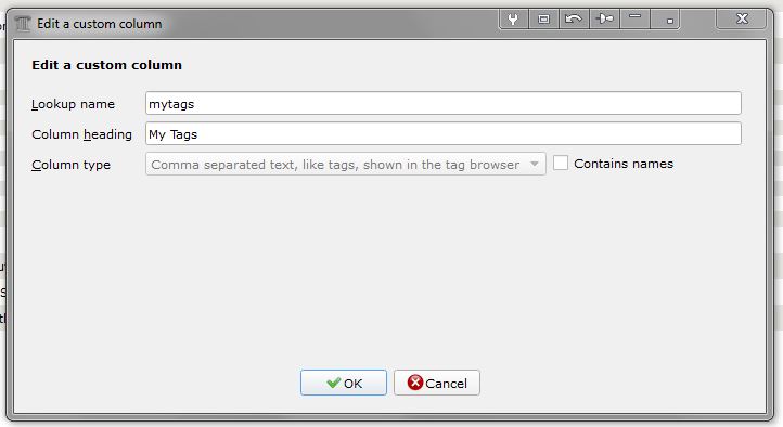

@rd4407 - do you mean a custom column as per attachment
The one you see is working for me.

@rd4407 - Can you confirm the Column Type is: Comma separated text, like tags, shown in the tag browser. I may be testing the wrong column type.
The word 'tag' has many meanings in calibre - in the context of the Tag browser everything's a Tag, in the editor one of these <xxx> is a tag
