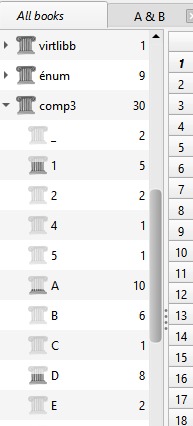

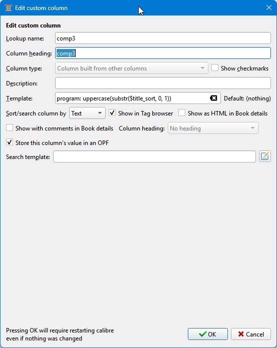

Assuming you don't insist on having buttons...
You can add title sort to the tag browser using a column built from other columns. For this case you would probably want to use the first letter of title_sort, not the entire title. This template does that
program: uppercase(substr($title_sort, 0, 1))
Be sure to check the "Show in tag browser" box.
