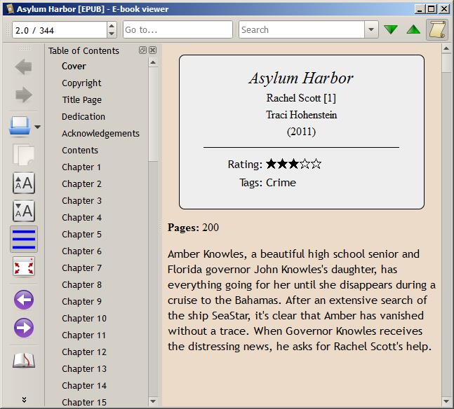

Originally Posted by jecilop View Post
My goal is to remove some info and add info from custom data fields to my book jacket.
I just can't figure out how to go from what I want to making it happen.
Can anyone help?
I may be able to help, but unfortunately, having read your attached files, I have no real idea what you're aiming at. So, on the assumption that looking at an example helps you identify what you do/don't want - here's a sample. I don't have a #words custom column so I've had to use my #pages custom column instead.
If you specify, in simple English, what visual changes you want, I'll try to oblige.
NB: Do not let MS Word anywhere near xhtml/css files that you want to edit. Use a good text editor instead (on Windows Notepad++ is good).

Where I am after feedback...
THANK YOU EVERYONE for you input and clarification of thread location. This seemed the place since I saw other threads on editing metadata templates here. I do hate when people don't take the time to figure it out. EACH reply is addressed below.
@BETTERRED, thanks for the input. I, however, cannot find the config folder. I tried ProgramFiles..., User/Appdata/Local... and Roaming..., and I looked at files under the main folders and do not see the referenced files that match the resources/catalog files you mentioned. I too start by learning to "hack away" and pick up more as I go. However, I cannot find what you reference although I would like to for the future. Perhaps a FULL LOCATION PATH would be more helpful. If I overlooked the obvious, I can slap my head with a, "Doh!" after seeing it.
@JACKIE_W, thanks for the visual. You have the right idea. I use the Count Pages plug-in for pages and words. I would like that info in the book metadata jacket also and not just as a column I see in Calibre. The lookup name is Words. I don't know if in this case you use Words or #words. I suppose it can't hurt to show both Pages and then Words.
I want to modify the following (a sketchup picture is attached):
  1. Remove Publisher name from showing
  2. See series indicated as you have Series Name (#) rather than Book # of Series Name
  3. I would like {author_link} to show under the author's name assuming the field is populated. A label is not necessary. Again, if it cannot be added in this area, then immediately after the "boxed section' is fine. I THINK I'm naming that field correctly as I saw it in other things. If possible, I want it to generate as an active link.
  4. Indicate Pages and Words. This would preferably be located under the Publish Date in the "boxed" section, but if Chaley's reply is accurate, then it has to go in the "footers" area like your picture. This is fine too. I would like Appx. to show before the words label IF POSSIBLE.
  5. I want the tags to stretch the full width of the box rather than just to the right of the label. It looks really bad now because I choose long tags and many. I moved {tags} below {tags_label} in the xhtml when I viewed the table using MS Word but cannot see if it was effective because I can't get things to where they need to be to test. If {tags} have to show in the footers section also, that would be fine as long as it can have {tags_label} right above it.
I figured out some of the saving to xhtml after research, trial, and error, but I cannot figure out where to put things now and if I have to modify the stylesheet.css in order to test my changes.
I would need some direction, if BETTER RED is accurate, as to where to place the modified file(s) if ProgramFiles../Calibre../resources/jacket is not the correct directory. FULL LOCATION PATHS are most helpful.
ATTACHED is a picture of what I would like. Also attached is the epub I made to generate this info in case it helps with anything.
@CHALEY, you information was helpful in framing the above ideas, but it's not something I can try yet because I can't get files where they need to be to work. It's probably simple, but I'm baffled right now. I can't learn how to do composite columns until I can test my tweaking. (By the way, I am in Calbre 2.1) I'm hoping help, perhaps as from JACKIE_W, will get me there. I need the visual now to overcome this learning hurdle. Thanks.
SIDE NOTE: Anyone know how to get the tags to print alphabetically like they show in the book details pane and columns? I know that when in Edit Metadata, they show according to how they were entered. I see they print in the Book Metadata Jacket the same way. I'll likely ask this as a separate thread later.
Name:	Book Metadata Jacket Template MARKUPS.jpg
File Type: epub _Test Author -_Test Book Series 0- _Test Book Series MERGED (251words).epub (958.9 KB, 516 views)
Last edited by jecilop; 08-30-2014 at 11:15 PM. Reason: edited attached photo and typos

OK, here's an update. When they are in the correct place in my calibre config directory (Windows 7), the 2 customised jacket files are called:
C:\Documents and Settings\myuserid\Application Data\calibre\resources\jacket\stylesheet.css
C:\Documents and Settings\myuserid\Application Data\calibre\resources\jacket\template.xhtml
They are in the attached jacket.zip
Done as requested.
Custom columns Pages and Words can be "in the box". I've included them twice to see which you prefer, namely:
  • each on its own line as one row of a table with 2 cols (label: value) This is the calibre default for the part of the "box" below the ornamental line.
  • both on same line spread across full width of box, i.e. spanning the 2 default cols.
For Tags I've included 2 options:
  • In the "box", centred and spread across full width of box, i.e. spanning the 2 default cols.
  • Outside the "box", above the Comments.
Now the Bad News. I don't use Author links so I'm not sure how they're supposed to work or how/if they can be included in the jacket. (I tried simply using {author_link_map} but that didn't work) A more knowledgeable guru is required if you want to pursue this. chaley is the template maestro, but how much of the template functionality that works in catalogs can also be used in jackets, I have no idea.
Finally, I've attached a screencap of the new jacket using your test epub (with the excess Comments removed).
[ETA: I see Android as your Reader details. Based on my experience, some of the popular Android reader apps may make a complete pig's ear of the calibre jacket styling. On the other hand chaley's wonderful Calibre Companion app will mean you never need to bother embedding a calibre jacket at all. All the calibre metadata you could possibly wish to see without needing to open the epub (or azw3, pdf,... etc) at all.

@jackie_w
I have taken your modified file and figured out (finally) how to modify it even more. It took some missing components to Sharepoint Web designer to handle it for me and to help me see and learn the internals of it better!
Attached is a picture of the copy of the version I currently have set and properly working.
If you would like a return copy of the template and stylesheet, let me know. I'm going to post it for others if I can get info back on the below stuff.
FYI, I have two threads out there to see if I can find answers on the:
Alphabetical tags : https://www.mobileread.com/forums/sho...d.php?t=245516
and
Getting Author Links from the Author Mgmt section to show: https://www.mobileread.com/forums/sho...d.php?t=245524
Thank you again. This was a BIG help and now a jumping point for me.
SIDE NOTE: Yes, I've notice how my reader does some weird things with the metadata jacket formatting, but at least now the desired info is there. Readers can changes as well as the setup of my reader. I let my "standard publication" appearance be what I see in Calibre Viewer.
Name:	_Book Metadta Jacket UPdated.JPG
Last edited by jecilop; 09-01-2014 at 10:25 AM. Reason: updated to correct copy of picture.; don't submit or save when you haven't slept!

Sorry for my bad english .....
I use calibre portable ...
i try show custom data in custon columns in catalog (in section book description). I create catalog cartel e copy the main default file for modify. I can do more modify but when i use { _customcolumn} as a value return me error code 1 and specify do not recognize _customcolumn ...
There is the error log :
calibre, version 2.19.0 (win32, isfrozen: True)
Errore di conversione: Non riuscita: Crea catalogo
Crea catalogo
Sections: Authors, Descriptions
Catalog_EPUB_MOBI('Calibre Library'): Generating epub for tablet in GUI environment, locale: 'Italian'
connected_device: 'None'
book count: 47
opts:
author_clip: 100
catalog_title: u'Libri su Kobo'
connected_kindle: False
creator: u'marted\xec, febbraio 17, 2015'
cross_reference_authors: False
description_clip: 380
exclude_genre: u'\\[.+\\]|^\\+$'
exclusion_rules: ((u'Cataloghi', u'Tag', u'Catalogo'),)
fmt: u'epub'
genre_source_field: u'Tag'
header_note_source_field: u'#datalettura'
merge_comments_rule: ':before:False'
output_profile: 'tablet'
prefix_rules: ((u'Letto', u'#letto', u'Vero', u'*'), (u'Letto', u'#letto', u'Falso', u'\u2022'))
search_text: None
sort_by: None
sort_descriptions_by_author: True
sync: False
thumb_width: u'1.00'
use_existing_cover: False
Begin catalog source generation (0:00:00)
Books excluded by tag:
Custom fields:
#datalettura 'Data lettura' datetime
#formats 'Formati' composite
#letto 'Letto' bool
#pagine 'Pagine' int
Thumbnails:
DPI = 132; thumbnail dimensions: 132 x 175
existing thumb cache at E:\Calibre Portable\Calibre Settings\caches\catalog\thumbs.zip, cached_thumb_width: 1.00"
Ordinamento titoli (0:00:04)
Ordinamento database (0:00:04)
Miniature (0:00:04)
Descrizioni HTML (0:00:14)
unhandled exception in catalog generator
Python function terminated unexpectedly
u'pagine' (Error Code: 1)
File "site.py", line 132, in main
File "site.py", line 109, in run_entry_point
File "site-packages\calibre\utils\ipc\worker.py", line 193, in main
File "site-packages\calibre\gui2\convert\gui_conversion.py", line 68, in gui_catalog
File "site-packages\calibre\library\catalogs\epub_mobi.py", line 404, in run
File "site-packages\calibre\library\catalogs\epub_mobi_builde r.py", line 289, in build_sources
File "site-packages\calibre\library\catalogs\epub_mobi_builde r.py", line 2835, in generate_html_descriptions
File "site-packages\calibre\library\catalogs\epub_mobi_builde r.py", line 2758, in generate_html_description_header
File "site-packages\calibre\library\catalogs\epub_mobi_builde r.py", line 2666, in _generate_html
KeyError: u'pagine'
When i set a parameters for create catalog in the other options / additional description does not show me in the list the column I want. In any case, I would view the data from more custom columns and do not think it's possible.
is right or am I wrong something?
Why its function in jackets book and no in catalog???
TY for helping me ....
Best regards
