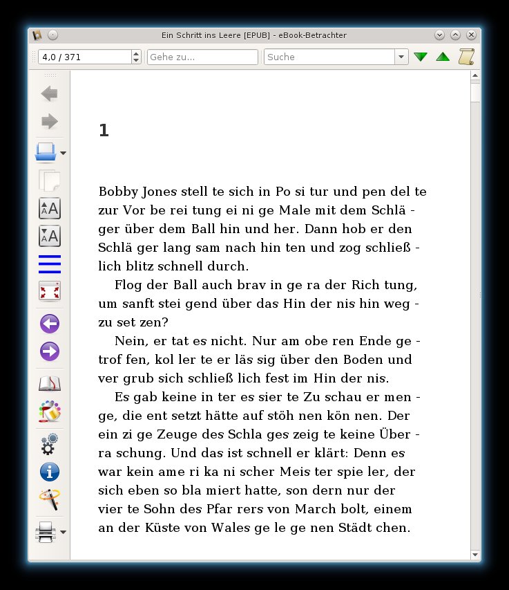

It's a bit late for the beta thread, but before opening a bug report...
With some (not all) eBooks, the ebook viewer shows spaces in words, that is, there are spaces between the syllables. I've never noticed this with the Qt4-based calibre.
I've not (yet) found a copyright-free eBook affected by this, but I've attached a screenshot which shows the problem. Is this a known problem or can anyone confirm it?

Whatever font that book is using probably has a space character for the soft hyphen, causing that problem. But it's hard to be certain without access to the book.
Now I've found an example file. What makes me wonder is: Opening it within calibre (or directly via the file manager) shows the problem. Saving the file to disk and opening afterwards via the file manager does not show the problem. Not sure what calibre does while saving to disk.
