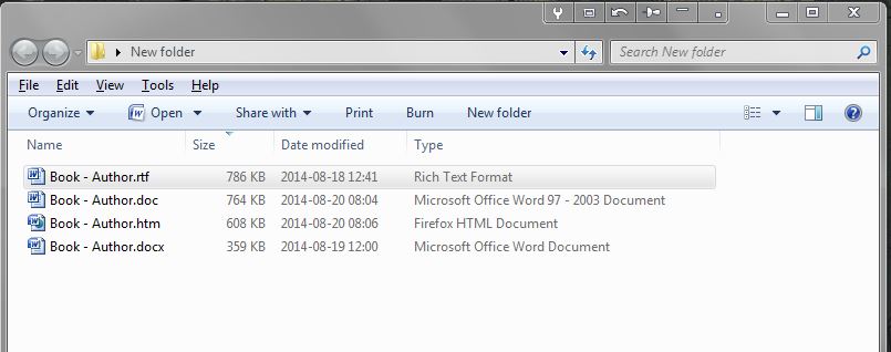

Old 08-19-2014, 06:25 PM   #13
Posts: 22,863
Karma: 34252730
Calibre converts DOCX and RTF without the need for a plugin. Also, this plugin hasn't been updated to work with the new QT5 version of Calibre coming next Friday. So if you'd best get a new workflow that doesn't rely on this plugin until it's been updated.
and
There is also the option of saving as Filtered HTML and converting it to whatever.
Another advantage of DOCX is that the file will usually be smaller than the equivalent .DOC, .RTF or .HTM
