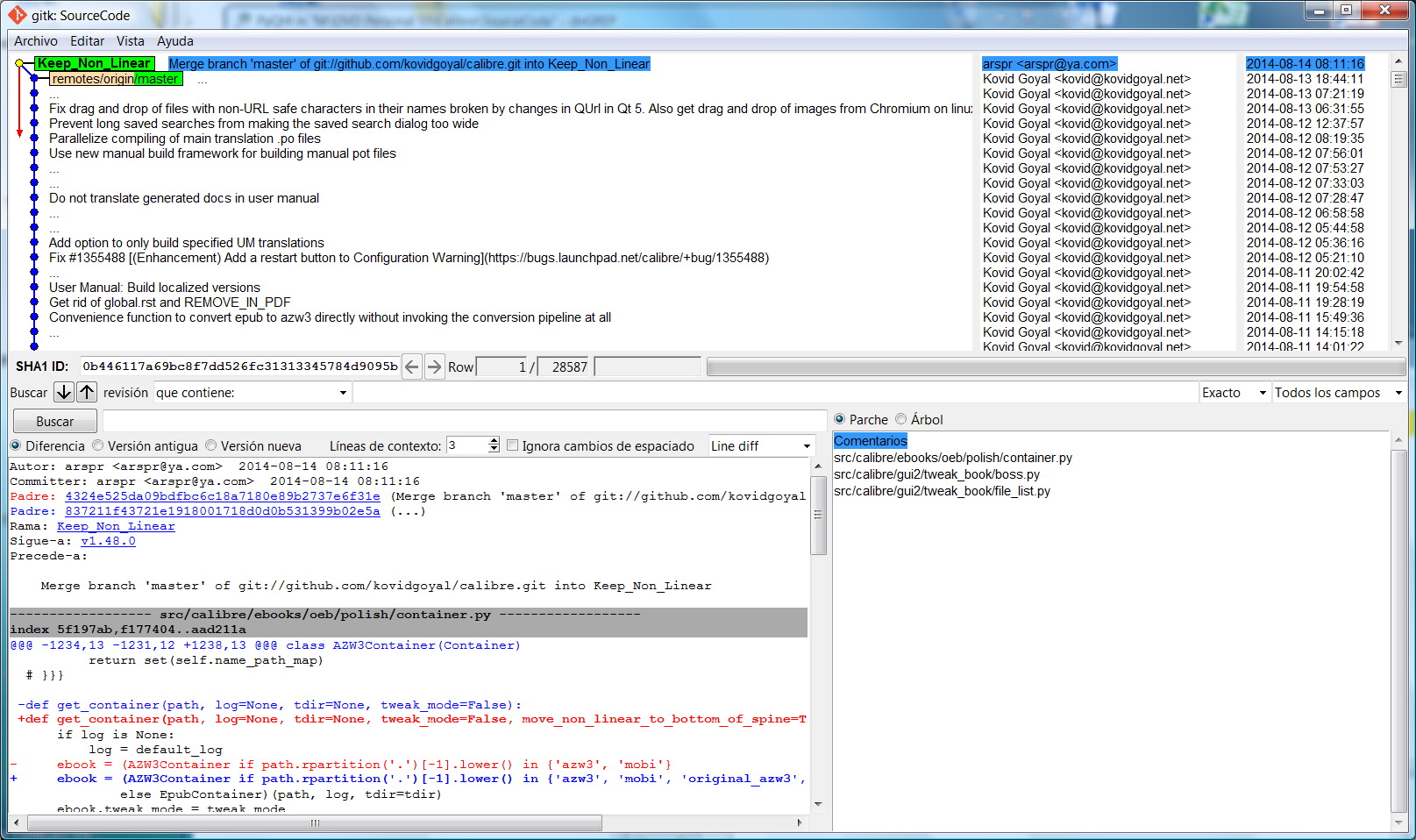

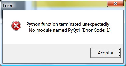

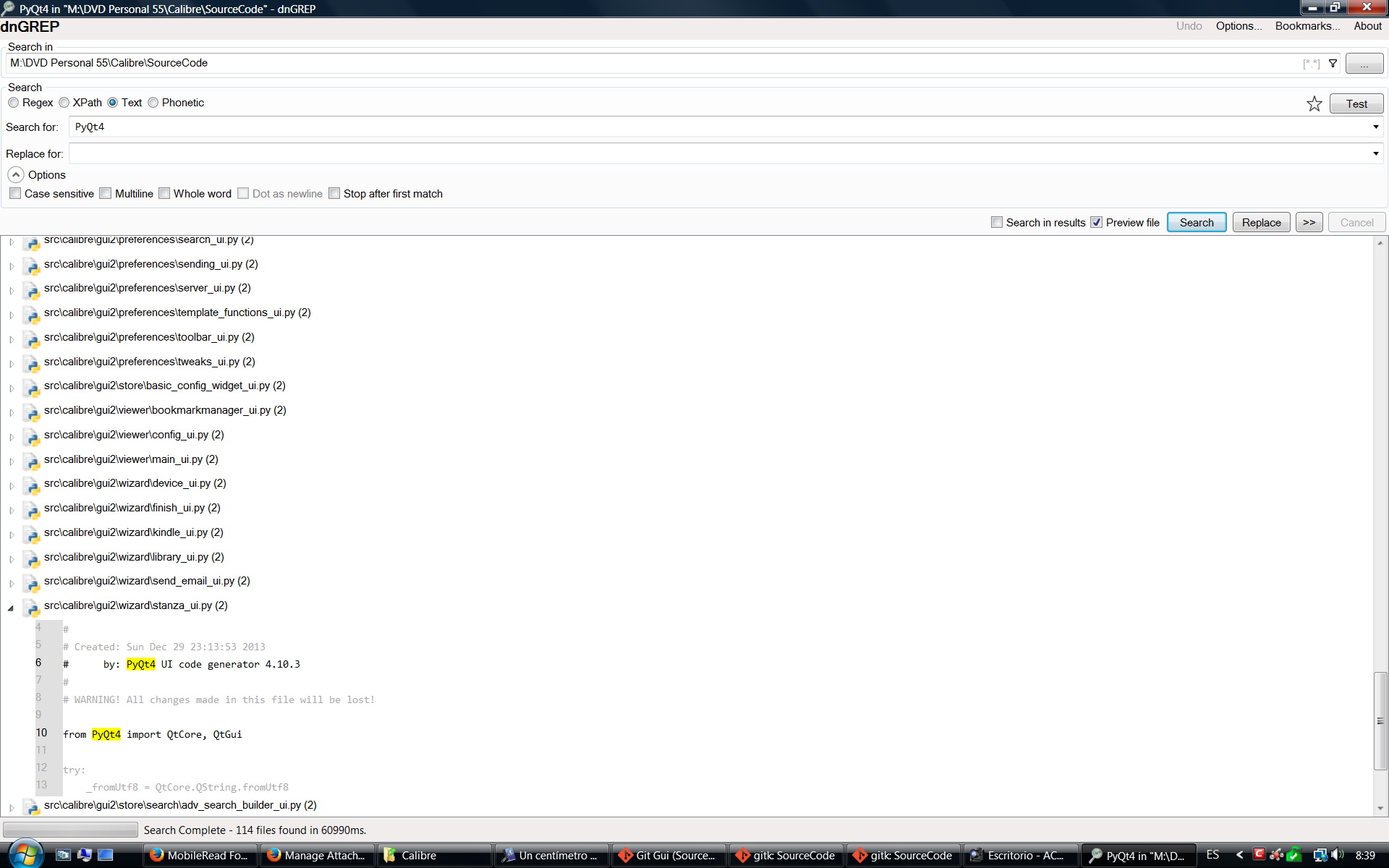

Wow, I missed this thread although I had noticed that I could not run from source since last weekend..., (well, I could because I kept my version old enough, not merged with the tracking master branch). Some message about Qt5whatever missing...
Just a heads up for people running from source. I have now merged the qt5 branch into master. This means that if you want to run from source, you have to use the beta version of calibre.
There's something strange here. I've installed the beta version, I've updated my source and now I cannot run from source because PyQt4 is missing...
I upload three screenshots:
  • The Qt4 error Calibre gives on launch.
  • A snapshot of Git GUI. So you can see the version I'm using. (Remember my changes are irrelevant about this issue, they're just about how non-linear items are managed/displayed).
  • A screenshot of dnGREP running through calibre source. In fact, there seem to be a lot of "PyQt4" in the code.
Am I doing something wrong?

Old 08-14-2014, 02:56 AM   #86
chaley
Posts: 12,529
Karma: 8125420
Location: Notts, England
This happened to me as well. The problem is that the generated user interface files are not regenerated. Recursively delete all *_ui.py files and you will be fine.
Old 08-14-2014, 03:28 AM   #87
arspr
Dead account. Bye
arspr ought to be getting tired of karma fortunes by now.arspr ought to be getting tired of karma fortunes by now.arspr ought to be getting tired of karma fortunes by now.arspr ought to be getting tired of karma fortunes by now.arspr ought to be getting tired of karma fortunes by now.arspr ought to be getting tired of karma fortunes by now.arspr ought to be getting tired of karma fortunes by now.arspr ought to be getting tired of karma fortunes by now.arspr ought to be getting tired of karma fortunes by now.arspr ought to be getting tired of karma fortunes by now.arspr ought to be getting tired of karma fortunes by now.
Posts: 587
Karma: 668244
Join Date: Mar 2011
Solved
Nevertheless, with the transition, if this is going to automatically happen I suppose you should add a clear warning in the manual, release notes or wherever, about this issue. Or possibly a lot of noobs, like myself, are going to ask the same question.
