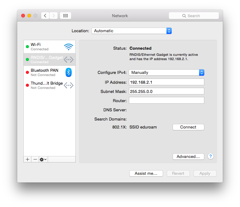

You do have to set the IP up in OS X's network manager, there's no DHCP.
EDIT: Except, well, with the IP that matches your config. I happen to be using the 'old' defaults of the K2/K3 era, whereas the K4/K5 USBNetwork installer uses the same settings as diags on fresh setups (i.e., set the IP to 192.168.15.201 instead).
