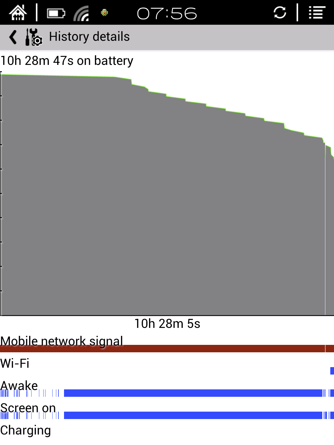

More (battery) feedback:
I have charged the reader 100%. I read 2 hours backlight on using the minimum setting.
Wifi and bluetooth are off (also turned off the "Mobile network data" in the Settings, just so it doens't appear in Battery info).
After that battery is shown at 99%. Great! I think.
I put the reader in standby (not turned off).
However after 8 hours this morning: 75%. And, as I was looking at it, it goes rapidly in a minute or two to 70% !!
I start looking at battery info in Settings, turn of Wifi, install a Task Manager, prod a bit.
In half an hour: 65% !
The attached battery graph shows how the rate of discharge is very small for like 4 hours (I estimate) and then it increases and stays like that.
The Battery info only shows:
- Screen 65%
- Cell standby 32%
- Device idle 3%
That in itself is a bit strange as the OnyxReader is not in there although I read for a couple of hours. So I'm not sure how much I can trust it.
But if it's true then it means it was not a process that started during the night and ate the battery ...
Is anybody else experiencing poor battery performance ? maybe associated with the reboot/freeze issues or not ?

Actually, if you take a look at the battery graph in my previous post, and if I read it correctly, it says that the reader and screen were NOT on while I was actually using it (reading), but afterwards is on continuously ?!
I think I'm reading it correctly, because you can see towards the end of the bars how it shows the awake/screen on being intermitently off again once I started using it in the morning again.
It shows how I turned on wifi and how it was not charging at all during this time.
More testing is necessary to understand this ...
The graph seems to say your screen was on and your device fully awake for the majority of the time. Suggests a failure to go to sleep properly.
On a Nook ST, I installed an app that forces the device to go into deep sleep to stop partial and full wake locks (think that's the term). The big problem on the Nook was that the cell phone part of the OS was trying to call all the time. I wouldn't think that would be the problem here, but again, you can install apps that breakdown battery usages by process and also show wake locks.
But that shouldn't be necessary on the Onyx, but it's fun to do anyway. Tweek away!

I moved phone.apk and telephony.apk out of the system/app folder and the battery graph no longer shows the cell standby battery usage. This has apparently helped on other tablets to reduce battery consumption. Will let everyone know if I see a difference in battery life.
