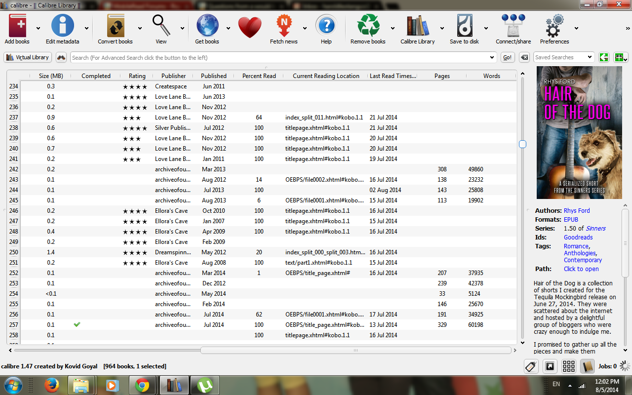

Originally Posted by hleo12 View Post
How many columns did you make, by the way?
Mine looks likes this:
Attachment 126358
I just made one test column Reading Status. I am now going to try two, Percent Read and Last Read as suggested by davidfor. That is actually what I wanted in the first place.

Originally Posted by falkunmalti View Post
Thanks. I am now going to try that. By the way, do I need to fill in the dropdowns under Other Options? What are those used for?
Not really, but they are handy. If you have the button for the plugin on the toolbar, setting these options to one of the actions means pressing the button will do that option. That makes it easy to run that function.
Attachment 126358
Hi
Where do you get the information for pages and words?
falkunmalti is offline   Reply With Quote
Hi
Pages and words come from another calibre plugin "Count Pages"
