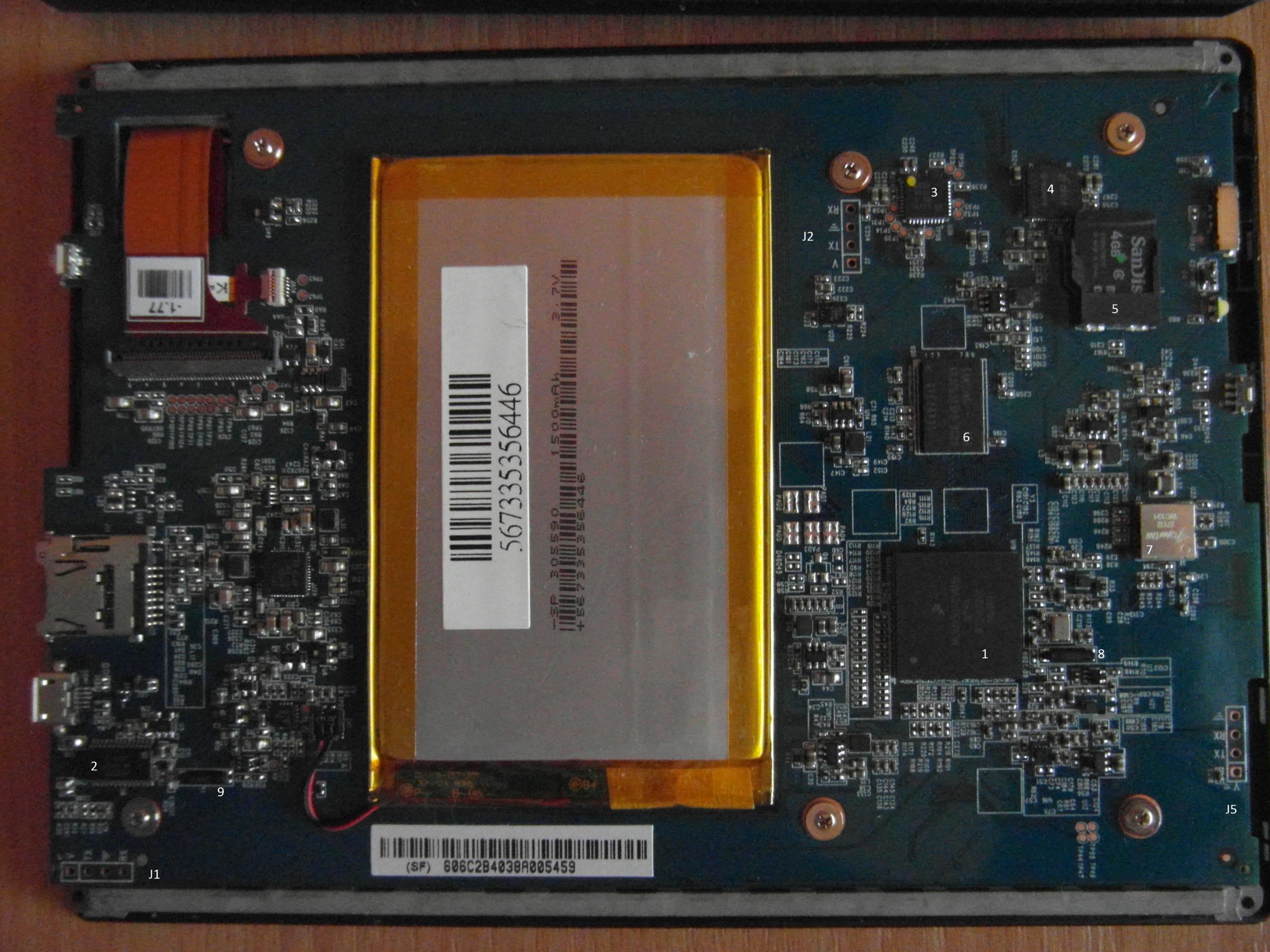

Old 12-16-2016, 02:08 PM   #5
Markismus
Markismus causes much rejoicingMarkismus causes much rejoicingMarkismus causes much rejoicingMarkismus causes much rejoicingMarkismus causes much rejoicingMarkismus causes much rejoicingMarkismus causes much rejoicingMarkismus causes much rejoicingMarkismus causes much rejoicingMarkismus causes much rejoicingMarkismus causes much rejoicing
Markismus's Avatar
Posts: 963
Karma: 149907
Join Date: Jul 2013
Location: Rotterdam
Device: HiSenseA5ProCC, OnyxNotePro, Note5, Kobo Glo, Aura
Hey Ken,
I am trying to get the serial connection to work on my old AuraHD (with a cracked screen). I've got the serial connectors hooked up to a TTL2USB connector, have a program maintain a connection to it at 115200@ 8 N 1, but to no avail!
The serial setup is the same as the one I used to put Openwrt on my router, so there should not be a technical problem there. Any ideas? I tried both serial headers.
Image of the PCB
Markismus is offline   Reply With Quote
Old 12-16-2016, 05:31 PM   #6
Ken Maltby
Ken Maltby's Avatar
Posts: 4,466
Karma: 6900052
Join Date: Dec 2009
Location: The Heart of Texas
It looks like you are on the right serial port, (but your image needs to be within the 600x600 rules). Have you tried 9600? Something in your chain of devices may like that better.
Luck;
Ken
Old 12-16-2016, 06:14 PM   #7
Markismus
Markismus's Avatar
Posts: 963
Karma: 149907
Join Date: Jul 2013
Location: Rotterdam
Didn't upload the image, but used bb-code, so I circumvented the rules, I guess.
Tried 9600, no luck.

What intrigues me most at this moment is the line:
[17:54:10:299] ␍Hit any key to stop autoboot:  0
When reinstalling my router with Openwrt, basically turning it into a Linux machine, I had to short a connection (using a screwdriver) to trigger a different boot mode, that allowed me to upload system images of Uboot and the filesystem. The message from uboot was identical.
But how to hit a key?

Hi. Openwrt/LEDE hackery person here.
First off, I apologize if I've skipped over something that makes any of this irrelvant. I only briefly skimmed the conversation and I'm totally new to ereaders (just got my first Kobo).
Your baud is always going to be 115200 unless you specifically know otherwise, so don't bother with 9600; this thing isn't a Cisco.
Have you guys checked voltage levels on these devices? A lot of modern SoCs are going 1.8V instead of TTL/3.3V, and this is the kind of device that would want to be as low-power as possible. I don't know anything about these devices yet, so I don't know.
It is also possible that they specifically cut the traces or grounded-out the rx for production models of the device. Get out yer multimeter.
Oh crap. I just noticed that your USB-to-serial is a ch341. Personal opinion: ch341s are notoriously bad and I threw all of mine away years ago after much frustration. Get a FTDI or something else to make sure that it's not actually your adapter that is causing the problems. I learned this one the hard way: ch341 serial adapters are cheap for a reason.

@very_rude_Turnip Welcome to the discussion!
Two questions about those voltages:
1) searching for 1.8V FTDI on AliExpress generated no results.
2) If the serial port on the device side is already powered, you don't have to connect the Vc. Does it still matter whether your TTL2USB is set to 1.8V or 3.3V or 5V?
Yes, you are not going to find a 1.8V adapter -- not enough market demand yet. You would need to make a level shifter with a breadboard to step down from 3.3V to 1.8V. The only devices I have run into that are 1.8V on the serial port so far are a couple of phones, but even some routers (ipq806x) are 1.8V now.
A device like this would never be 5V. It's probably 3.3V. Small possibility of 1.8V.
I don't recommend connecting Vcc at all -- just ground tx and rx. Your serial port is already powered by the USB side.
I just cracked open my new Aura v2. There's the serial port. 4GB MicroSD card in there too -- no soldiered in. Interesting.
I will see if I can connect.
very_rude_Turnip is offline   Reply With Quote

Logged in fine for me using my pl2303 based ttl level adapter. Definitely try another serial adapter chip. ch341 = garbage! Get a pl2303 or FTDI. (Try to buy real and not China-fakes) Also double check the obvious stuff like connection, cables, etc.
>picocom -b 115200 /dev/ttyUSB0
picocom v1.7
port is        : /dev/ttyUSB0
flowcontrol    : none
baudrate is    : 115200
parity is      : none
databits are   : 8
escape is      : C-a
local echo is  : no
noinit is      : no
