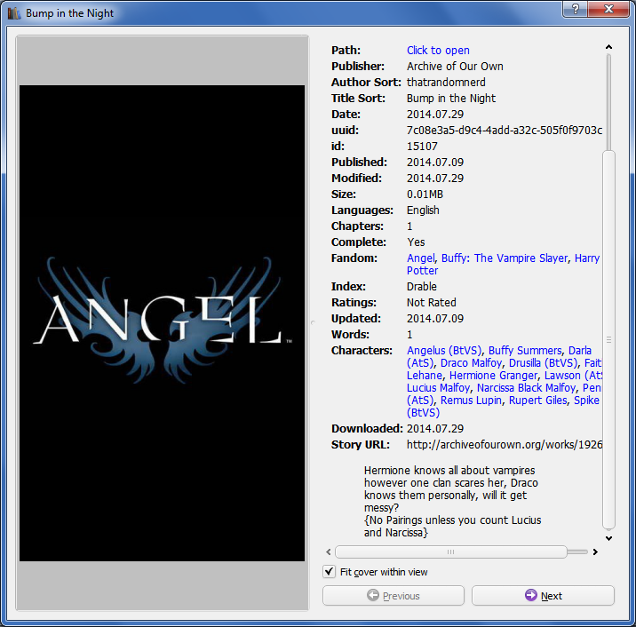

Is it possible to make the Author and Story URL "clickable", because at the moment they just show up as text. I've made two separate custom columns.
Name:	Skærmbillede 2014-07-29 08.39.59.png
Tanjamuse is offline
Old 07-29-2014, 04:10 AM   #3173
Firedancer885
Occassional Beta Tester
Firedancer885 can teach chickens to fly.Firedancer885 can teach chickens to fly.Firedancer885 can teach chickens to fly.Firedancer885 can teach chickens to fly.Firedancer885 can teach chickens to fly.Firedancer885 can teach chickens to fly.Firedancer885 can teach chickens to fly.Firedancer885 can teach chickens to fly.Firedancer885 can teach chickens to fly.Firedancer885 can teach chickens to fly.Firedancer885 can teach chickens to fly.
Posts: 284
Karma: 3516
Location: Hungary
Use the Author(s) option instead of the Author sort. Author(s) is already clickable. Add identifier to your options. It's also clickable and contains the story url.
