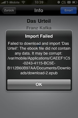

Hi,
Crazy, thanks for the complements for pdaConverter.
Sadly for my router there is no modified I know of. (At least Tomato and DD-WRT don't support it). But in the meantime I was able to mainly solve my network problems. It had to do with a wireless AP I use to connect my Linux XBOX to the network.
So basically it works, but the server acts strange and I think I found the problem. I have exactly the same behaviour that tHeFiRsTiDioT described.
I cannot ping my PC using the hostname, when I started the server with the command server-calibre --hostname=jakewalk and add http://jakewalk:8080/stanza to stanza's online catalog it doesn't work, but starting the server without any parameter and using the IP for the catalog seems to work: http://192.168.2.79:8080/stanza
But when I try to download a book it doesn't work (see attached IMG_0002.jpg). Then I looked at the XML file and it is apparently not correct:
<entry>
<title>Urteil</title>
<id>urn:calibre:7</id>
<author><name>Kafka</name></author>
<updated>2008-11-13T09:43:51+00:00</updated>
<link type="application/epub+zip" href="http://localhost:8080/get/epub/7"/>
<link rel="x-stanza-cover-image" type="image/jpeg" href="http://localhost:8080/get/cover/7"/>
<link rel="x-stanza-cover-image-thumbnail" type="image/jpeg" href="http://localhost:8080/get/thumb/7"/>
<content type="xhtml">
<div xmlns="http://www.w3.org/1999/xhtml"><pre></pre></div>
</content>
</entry>

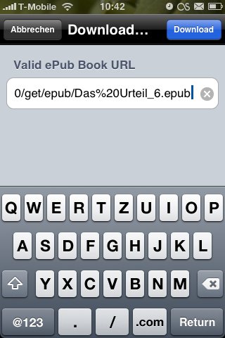

So I tried to manually download the epub file through Stanza's Option "Download Book at URL" (hidden in the settings) and I could succesfully import the file through the URL http://192.168.2.79:8080/get/epub/Das%20Urteil_6.epub (see attached IMG_0003.jpg) That's the prove that the network connection is not part of the problem.
I think the solution is simple. Could you please add a server parameter to the calibre-server.exe that allows using the IP-address in the XML-output instead of localhost? That should fix the problem.
I'm curious have you tried to specify your IP address to the hostname parameter?
Yes, that was my first idea, too. But it didn't work.

Crazy, I am sure you are right an I will have to investigate that network problem. For the moment I solved the problem by adding my IP to the iPhone's host-file (/etc/hosts). Now it works and that's really cool. Thanks for your support here!

@jakewalk: You should be able to pass the IP address as --hostname to the server. For example is you use --hostname 2.3.4.5 your links in the feed will look like http://2.3.4.5:8080/get/epub/594
