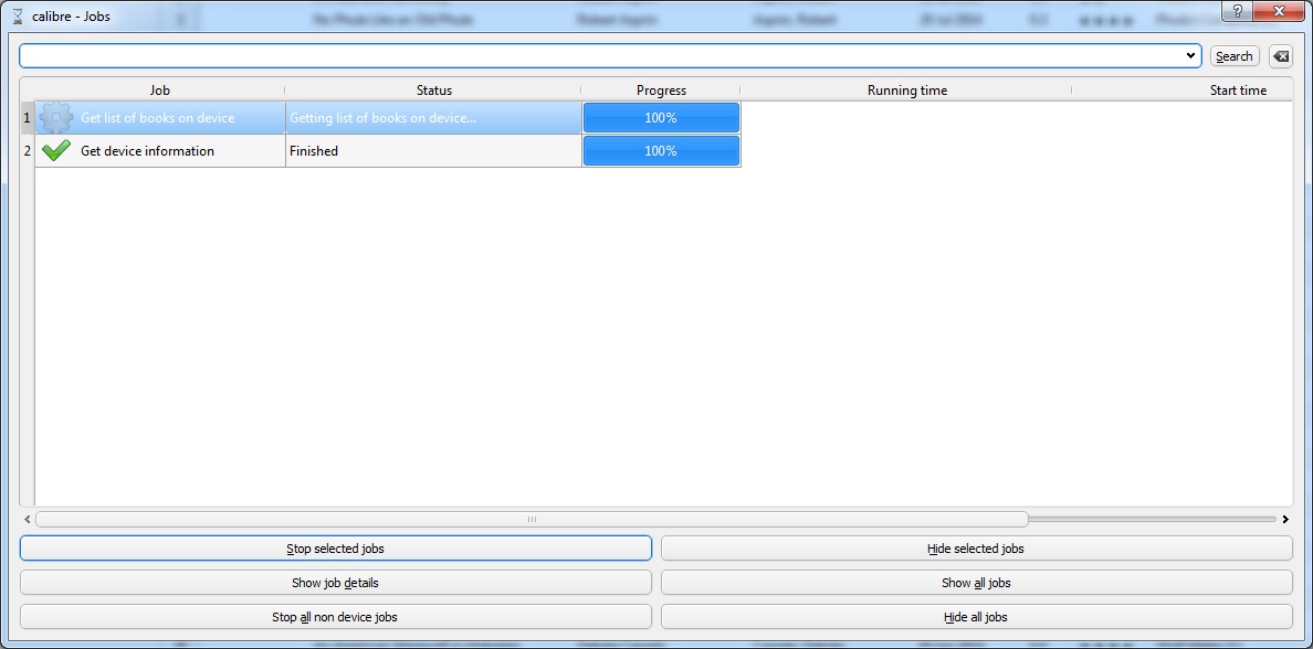

I don't know if I would call this a bug but it's a bit of an annoyance. When I connect my Aura HD to Calibre, the Get list of books on devices shows Working as the status for a few seconds, then switches to getting books on device. At the point, the progress goes from unavailable to 100% where it sits until the job is finished. I used to know that it took about 50 seconds for the job to complete but now the running time doesn't show so that is no longer helpful.
Regards,
David

@DNSB: I dont think this has anything to do with Qt 5. As far as I know, the behavior of the jobs dialog is identical in Qt 4 vs Qt 5. Are you seeing something different?

David: Are you using any of the jobs that the utilities plugin starts? These are created after the job that gets the book list finishes. The backup job seems to be the worst of them. The reading position job can take a while to setup, but it displays a progress bar so you know something is happening.
The time taken does seem to be longer with 1.203 than with the portable version of 1.46. But, it might be related to the size of the libraries I'm testing with. I'll have a look to see if where the hold up is.

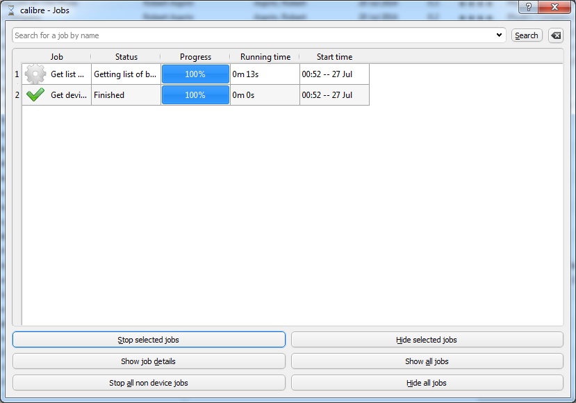

Finally had an attack of brilliance. I had installed the beta over the 1.x version after uninstalling the 1.x version (Windows 7 x64). I tried uninstalling the beta, installing 1.46 and saw the same behaviour but the columns in the job list were resizeable which they were't in the beta.
So uninstalled Calibre, deleted the calibre_cache and calibre directories in the local user and reinstalled. The job columns are now displaying properly and are resizeable with 1.203.1.
Hitting the patient in the head with a fire axe worked!
Regards,
David
This was when I first connected the reader to the computer and Calibre was loading the book information from the reader so Kobo Utilities was not involved -- I hope.
Sample pics attached but as previous message mentioned, issue went away with a clean install of the beta.
My bad...
Regards,
David
