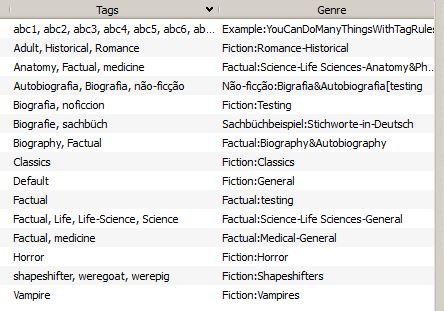

eval(xxx) Fixed The Problem
Kovid,
I changed the code to use the eval statement you specified, but did NOT print it to avoid a runtime error. It worked! Thank you for solving this. Great job.
