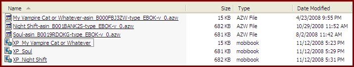

I just tried it with XP and had very good success. The only things I noticed is that even though I tried to name each of the book titles with an XP in front, the XP was left off and the normal title came through. I've been able to make changes like that in Vista with the previous version.
Also, even those this books were downloaded from Amazon as DRM'd .azw files, they were renamed with the .mobi extension. All books opened just fine.
Here are some pics. I'm off to try Vista next.

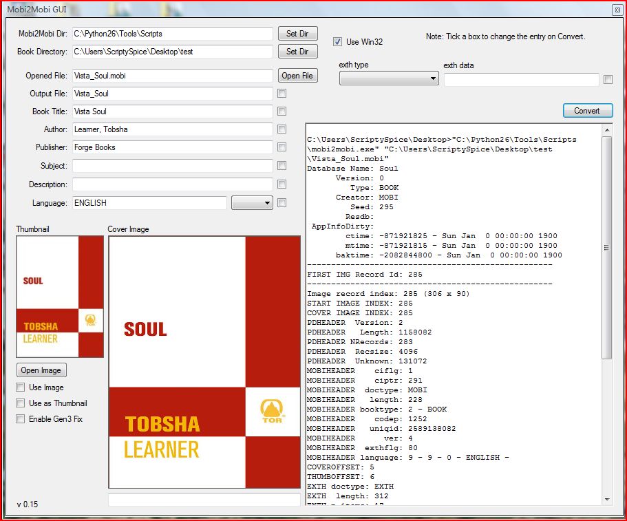

Any fields that you modify within the GUI requires you to tick the modified tickbox. This flags those entries as requiring updating during the convert process. The GUI will always output files with a .mobi extension as technically this is what they now are.

I did check the box but nothing happens in Vista either (see images 2 and 3).

Hmm. Looking at the 2 screenshots it looks like the ticked changes worked fine. The output filename you specified and the book title all look fine. After a convert the GUI opens the converted .mobi file to repopulate the fields to confirm your modifications were successful.

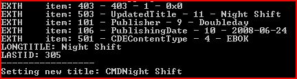

I just finished the command line version and it doesn't seem to be working either. The file name changes but the book title doesn't.
I've been working on a Kindle Visual guide using a DRM'd file from BooksonBoard which has worked no matter what I've thrown at it (even after Kindlfixing into a .azw file from .prc). This Amazon version is kicking my butt.

On the Kindle there have been reports that the "updatedtitle" will over-ride the longtitle (from --title), and that if this already exists you may need:
mobi2mobi --outfile [output filename] --exthtype updatedtitle --exthdata "[Corrected Title]" [original AZW/MOBI filename]
