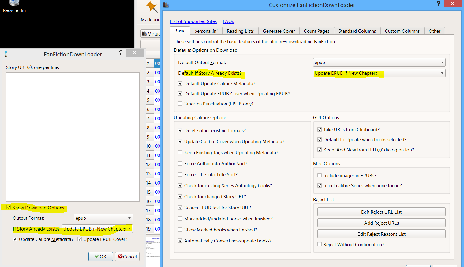

Old 07-22-2014, 09:40 AM   #3144
Tanjamuse
Posts: 1,327
Karma: 5306
Join Date: Jan 2014
I'm sorry but I can't find the setting, maybe you can post a screenshot?
Tanjamuse is offline
Old 07-22-2014, 09:43 AM   #3145
JimmXinu
Plugin Developer
JimmXinu's Avatar
Posts: 7,608
Karma: 5010535
Location: Midwest USA
It's not hard to find if you look...

Old 07-22-2014, 09:45 AM   #3146
Tanjamuse
Posts: 1,327
Karma: 5306
Join Date: Jan 2014
Thank you so much, I didn't even think to look there
