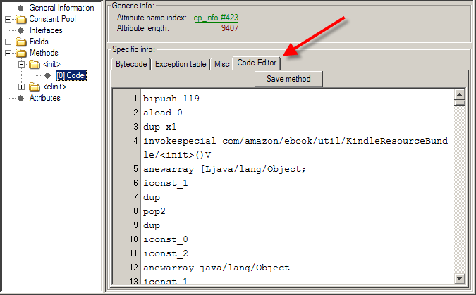

I followed your instructions from page 106 to try to set up smaller margins. I installed JBE and opened Margins/ReaderSDK-impl-en_GB.jar/ReaderResources_en_GB class then went to Methods -> [0] init -> [0] code but I don't see any 'Code' tab.
Am I missing anything ?
Thank you.

cristi1848
JBE Code Editor tab:

Thank you for answering. For some reason, the Code tab didn't appear when I first tried it.
After unpacking the jar file and editing the ReaderResources_en_GB.class, when I'm trying to save, I get 'Error: Instruction requires an argument of type byte at line 786, instruction "bipush"' error. Any idea why is that ?
