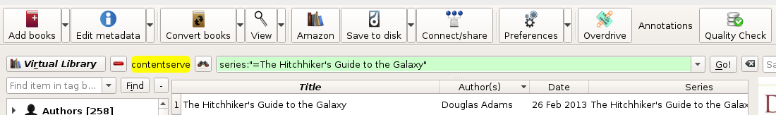

Whenever I activate a dropdown toolbar icon and drag the mouse down to exit it, it remains highlighted until I rollover it with the mouse again.
Looks kinda weird, especially when I get every single icon to look like that.

https://bugreports.qt-project.org/browse/QTBUG-40233

Reported upstream, got it. So we wait for them to fix it.

And here is a workaround for the Qt bug: https://github.com/kovidgoyal/calibr...7872db6849feb7
Quite graphic
