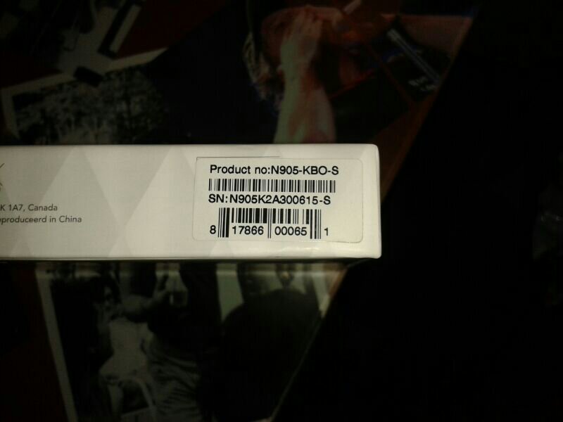

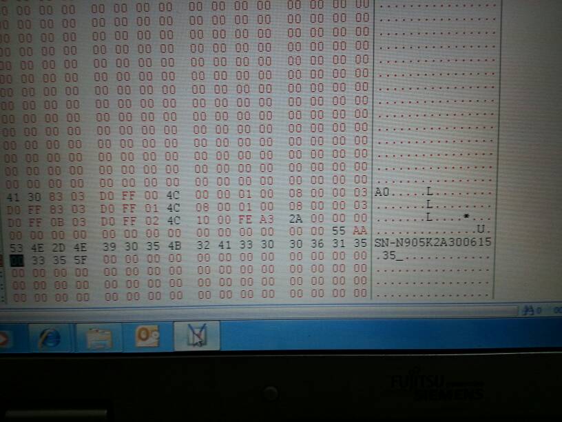

Originally Posted by V!to View Post
Hi guys, i'm here again with new doubts and questions (don't*be angry with me) but i won't make another damages.
Well, now i must write my kobo serial number in sd card image:
my details are
Attachment 122502
product: N905-KBO-S
SN: N905K2A300615-S
In order to*write my serial i've used HexEdit and i wrote only this digits after positioning at offset 200
K2A300615
Attachment 122503
Is it*all right or should i write any other informations?

Originally Posted by pinonano View Post
Please help me!
My SN is: SN-N905K2B102977-B
I've tried to replace my broken SD without luck...
I tried SN-000000000000000, SN-N905K2B102977-B, SN-N905K2B102977.. ...
What I have to write exactly at offset 200?
Thanks for your support!
You should be writing "SN-N905K2B102977". The "SN-" is already there. The next 14 characters are the serial number. Then there is a null character.
