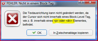

There is a change to entity code necessary for the following help string:
#: /home/kovid/work/calibre/src/calibre/gui2/tweak_book/editor/smart/html.py:493
String old (picture1):
Cannot change text alignment as the cursor is not inside a block level tag, such as a <p> or <div> tag.
String new(picture2, sorry in german):
Cannot change text alignment as the cursor is not inside a block level tag, such as a &lt;p&gt; or &lt;div&gt; tag.

Thanks, fixed.
