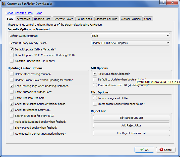

Tanjamuse
Posts: 1,327
Karma: 5306
Join Date: Jan 2014
Originally Posted by Tanjamuse View Post
Now, it pick up the first link, I would love to have to avoid the copy-paste of the rest. If there is that function, I haven't found it
I hope this clarifies:
I've checked the box marked: Take URLS from clipboard? (as you can see)
But it only works for the first link, not the next ones.
Name:	Screenshot 2014-06-15 16.46.58.png

That's strange, it should work for every link. But I didn't do anything regarding the GUI, you'll have to wait for Jimm to answer.
This is still working fine for me on Win8. That code hasn't been touched in some time.
What are your exact steps when you see a problem? What page and program are you copying from and how? What OS?
I do know that I can't drag more than one email out of Thunderbird onto the FFDL button at a time anymore, but that's a Thunderbird bug and they weren't interested when I reported it.
