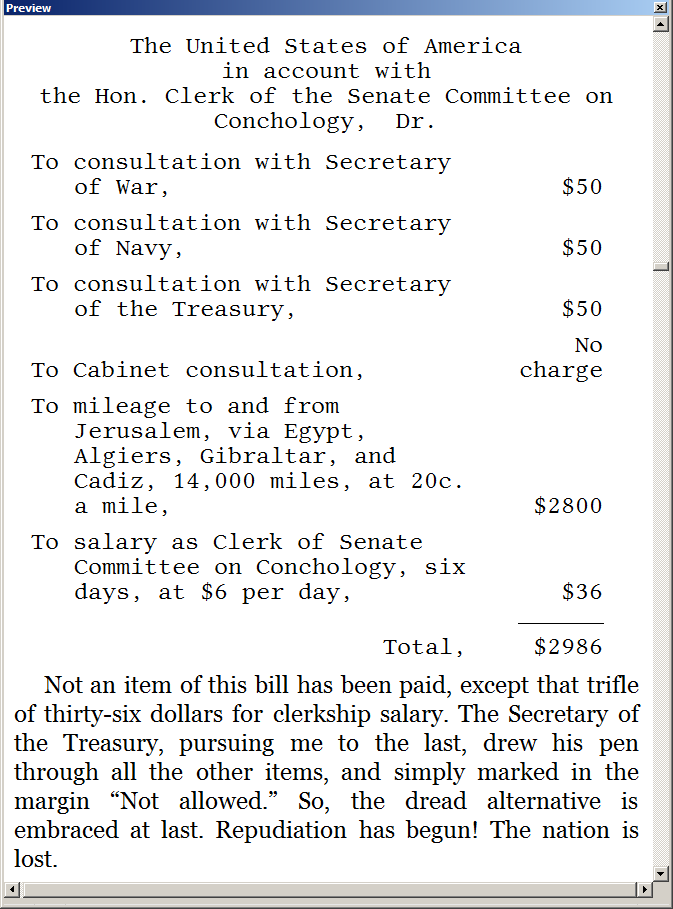

@Weberr -- I don't know if this is what you are looking for for text alignment, but this works for me. I set the alignment in the individual cells. (I have never worried about hyphenation and let the app/device worry about it instead.) I don't set a fixed font size, and only use relative font-sizing, ie, 80% or .8em.
Of course, I only work with fiction, so my needs are very simple. This is what I used recently, with an embedded monospace font (it is a bit more attractive than the default reader font).
Sample css code

This is a very simple three-column table with no borders. The middle column is just to provide more spacing between the text and the numbers.
