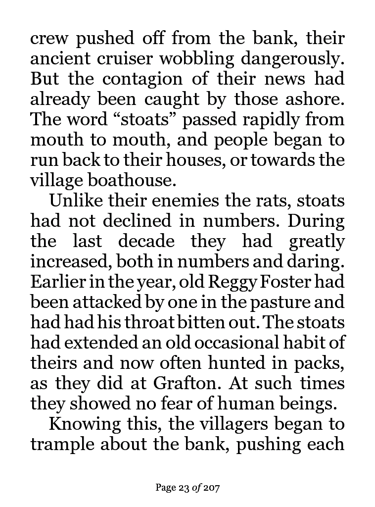

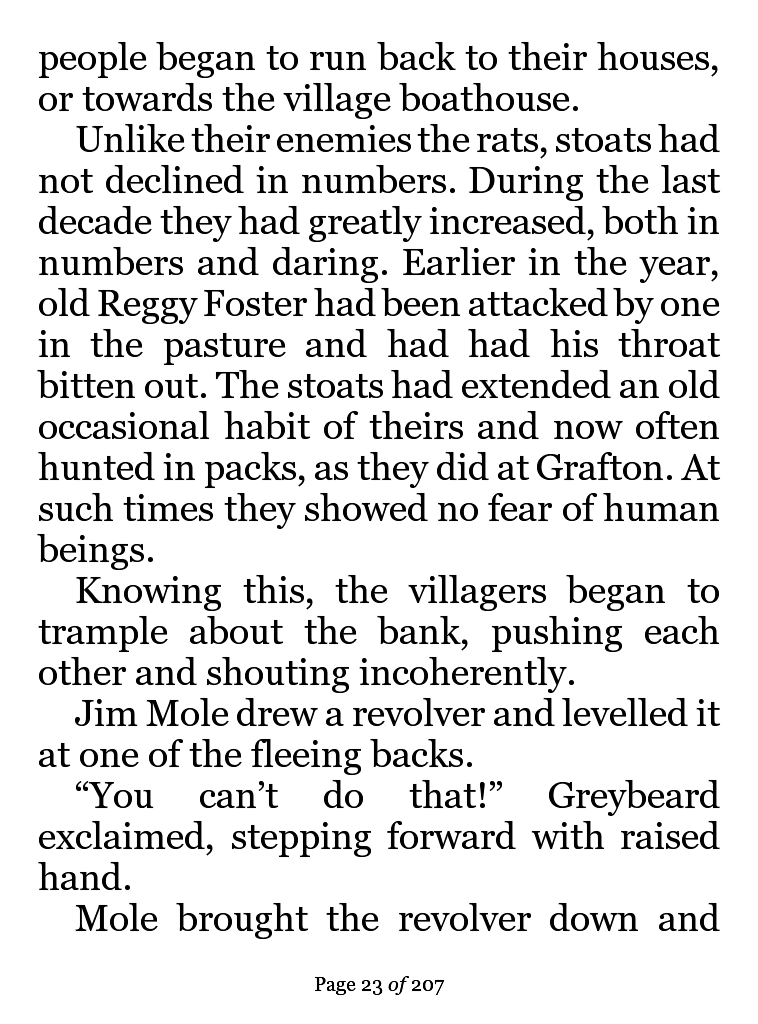

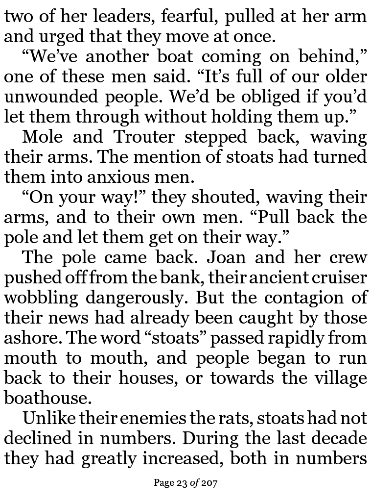

Here are some screenshots of an epub on my Glo with the margin slider at three different positions (0, 4, 7). The adjustable margin patch is applied with the top and bottom and 2x scale options, units in pt, and the footer patch is applied with min/max-height: 30px, padding-bottom: 25px.
(obviously the bottom margin will still vary depending on font size, line spacing etc.)
