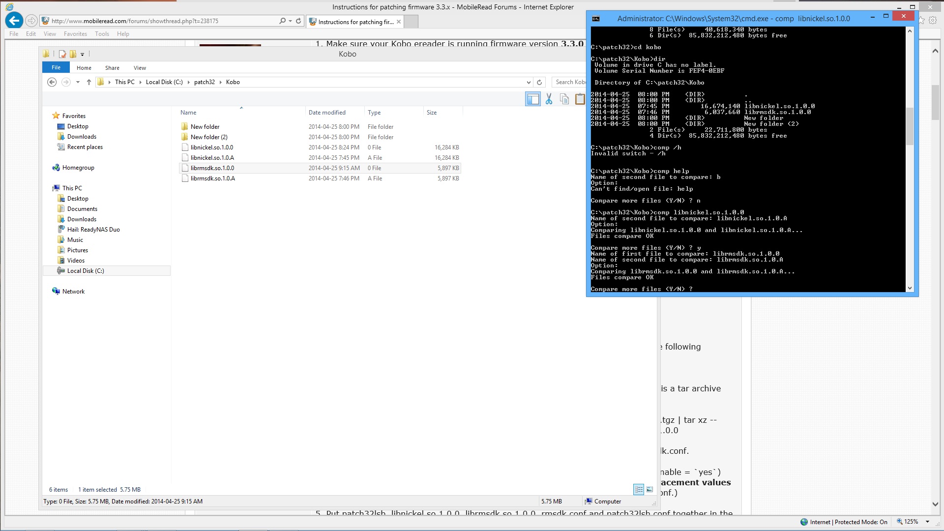

That they are the same size is not much of a guide, could you check them with the comp command? (I think this the equivalent of unix's cmp command, it checks that the files are identical).
Done! Files are the same. See the attachment. Let me know and I can post the files if needed.
