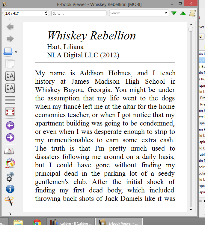

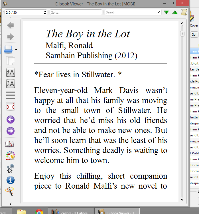

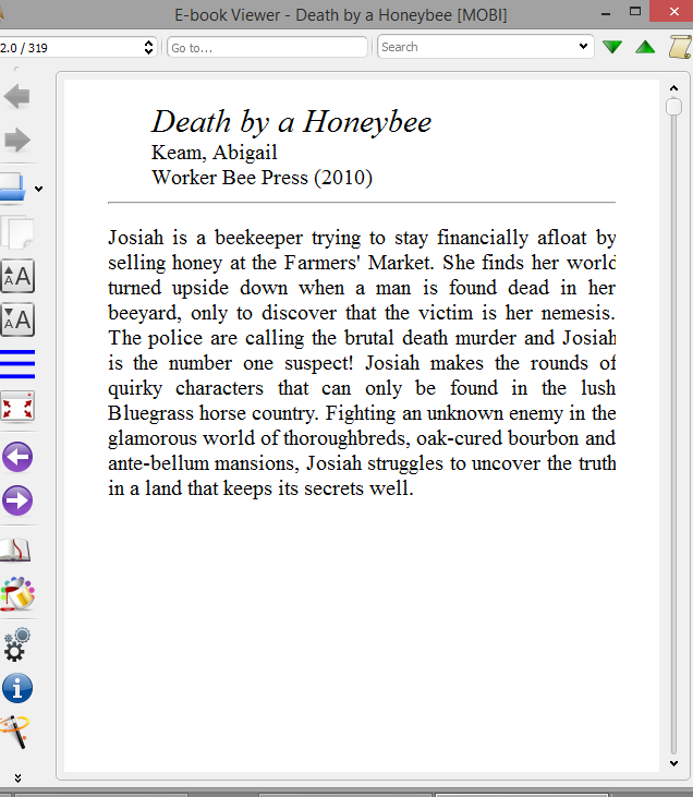

Book jacket font size issues - epub>mobi conversion
I've been having some font size weirdness with the inserted metadata page, where sometimes it comes out with a huge font. I'm really not sure what causes it, but I think it might be something to do with the "Source base font size is" line.
I've changed the book jacket stylesheet to remove tags and ratings, but I doubt that's related, as most of the converted books are ok. I'd thought it was happening more often with my epubs from Kobo, but it doesn't happen there all the time. I've definitely noticed the problem more with books from Samhain Publishing, and the attached image with the really big font is one of those. I've had it happen with a few of my amazon azw3 books as well. I also wondered if it was connected to using that plugin we don't really talk about, but I don't think it is, as I've had it happen with books that were completely drm-free to start with. I've also run lots of books through the plugin and had the metadata page come out fine. The attached Death by a Honeybee book jacket is one, and I attached it as an example of how it's supposed to look.
I was trying to find a public domain book that had the problem so I could attach it, but no luck so far. I did however find some that are free on kobo, so I hope it's ok to link to those. This one gives a book jacket with big font, and this one gives one with gigantic font. I've also attached the conversion logs for these.
I hope I've provided enough info to help fix this problem, as the metadata page is one of my favorite features (which is really saying something, given how useful Calibre is). Thanks so much!

Old 04-08-2014, 09:09 PM   #2
kristalana
kristalana ought to be getting tired of karma fortunes by now.kristalana ought to be getting tired of karma fortunes by now.kristalana ought to be getting tired of karma fortunes by now.kristalana ought to be getting tired of karma fortunes by now.kristalana ought to be getting tired of karma fortunes by now.kristalana ought to be getting tired of karma fortunes by now.kristalana ought to be getting tired of karma fortunes by now.kristalana ought to be getting tired of karma fortunes by now.kristalana ought to be getting tired of karma fortunes by now.kristalana ought to be getting tired of karma fortunes by now.kristalana ought to be getting tired of karma fortunes by now.
kristalana's Avatar
Posts: 152
Karma: 1170000
Join Date: Mar 2013
Device: Kindle PW2, Galaxy Tab Pro
I'm attaching one of the epubs I linked to above, to make it easier for anybody looking into it. This one gives a metadata page with giant font. It's an epub straight from the publisher (no drm), but it's a free book so hopefully I won't get in trouble for posting it.

But the font sizes in the rest of the book are fine, post-conversion. It's only the inserted book jacket that does this, in this or my other books where I've had the problem.

@kristalana The book you attached has the fonts for paragraphs at 70% of normal and the css for the book jacket has the fonts set to 1.1em which is approximately 110% of normal. When you view the book on your device you need to scaleup the 70% font to normal and the book jacket ends up giant.
Old 04-09-2014, 12:13 AM   #11
Posts: 46,501
Karma: 29634066
This is because your book specifies extremely tiny font sizes (50% of normal), while the jacket uses "normal" font sizes. Currently, the jacket insertion code does not try to alter the font sizes int he jacket to match the font sizes int he rest of the book, it is possible to have it do that, but doing that would mean a loss of control for people trying to customize the look and feel of the jacket.
In your case, you might be able to work around the problem by converting epub to epub without a jacket to normalize the font sizes and then converting again with a jacket (after deleting original_epub so that the newly produced epub is used).
Or just edit the source file to remove the silly repeated font-size: 70% declarations from the stylesheet.

Thanks so much Kovid! I thought it was something like that (the jacket not matching other font sizes). Converting epub>epub first, then to mobi worked perfectly.
