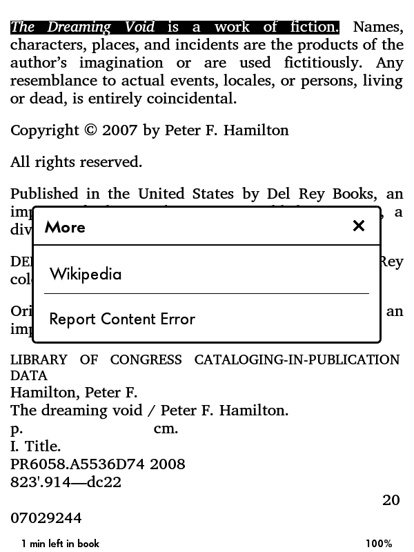

Ok. I did this:
- put only gtranslator.acx(the one before you correct it) to kindle. It didnt work
- If you said
Originally Posted by dsmid View Post
There was a bug ...
Therefore I've added appreg.db cleanup code to AcXE uninstall bundle (from version 5).
I uninstalled .. something with Update_acxe_5_uninstall.bin.
- Installed Update_acxe_5_install.bin
- copy the new gtranslator.acx to user store / system/acw/
Result: I don't have "Translate" or "Google translate" option in "More" Menu.
I am so bright
Can I undo what I did?
It's OK. Now delete all files in [userstore]/system/acw/ and reboot Kindle.
Then you will get stock ACXs only.
Install AcXE, put the fixed gtranslator.acx in [userstore]/system/acw/, reboot Kindle and you should see working Google Translate item in the menu.

Yes it worked. Now I have "Google translate" option.
Thank you!
