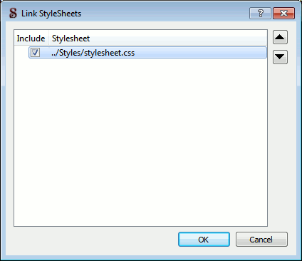

If you right click the HTML file in the left-hand side under the "Book Browser" and press "Link Stylesheets", you will get a menu which SHOULD show any CSS files included in the book:
ID:	121018 Click image for larger version
Make sure there is a checkbox in the box (meaning that stylesheet will be applied to that HTML file), and press Ok.
NOTE: If there are no CSS files, this list will be blank. This probably means there is CSS Styles at the TOP of your files (again, requested that you post actual code samples from your book).

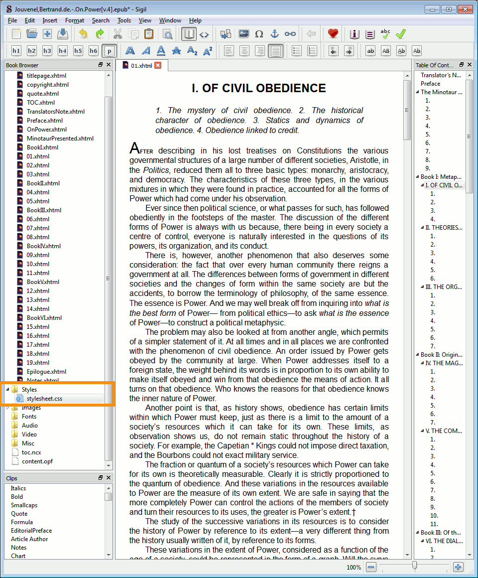

After applying the CSS file, the look of the book will change:
NOTE: IF you already have a CSS file, you should see it under the "Styles" folder (highlighted in orange). Posting the code from there will help us figure out what is causing problems.
