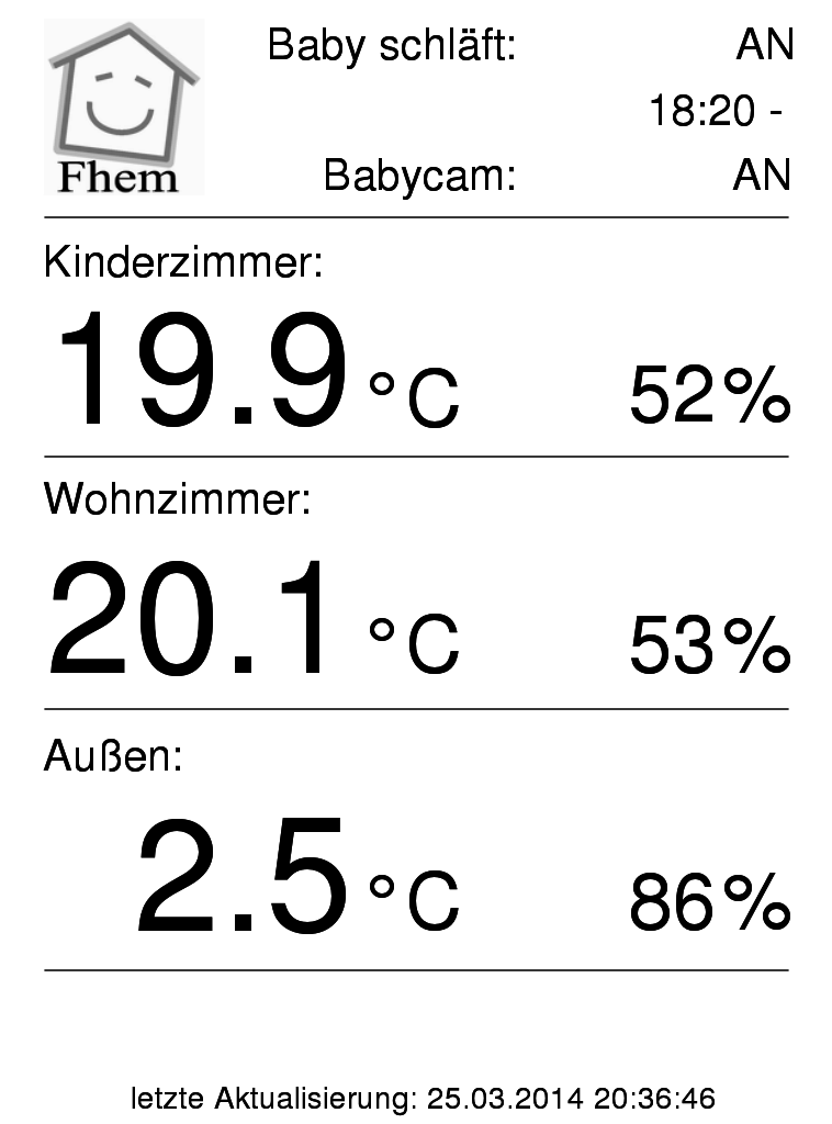

Out of curiousity: what are you updating your screensaver every 5 minutes with? I'm getting bored already with my weather display and am thinking of freshing it up :-)
I'm using an open source home automation --> www.fhem.de
The Kindle displays my home informations, like room temperatures, the state of my ipcam and when my baby is sleeping (see attached png).
Hades.
